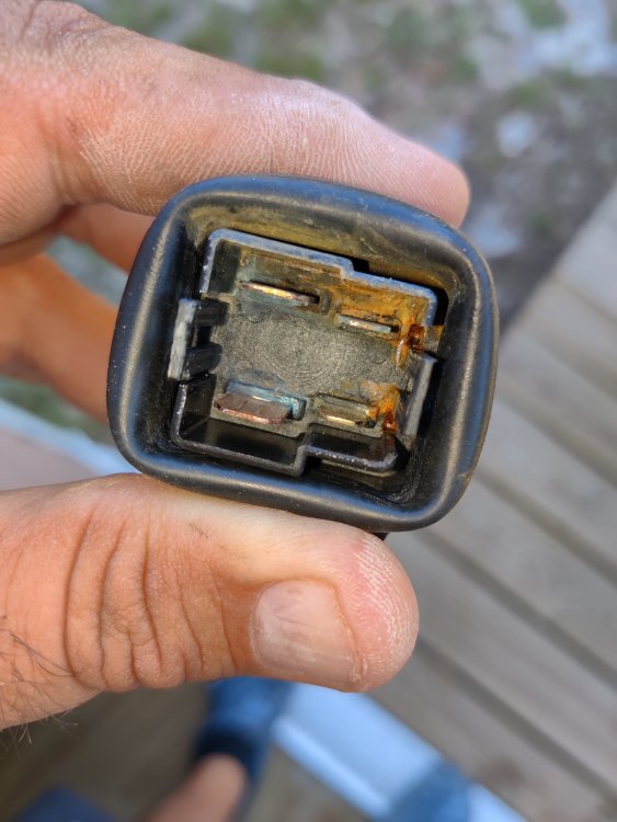

Finally spoke to the rep and there is an relay for the fuel pump, it's just not under the hood with the rest.
It's sitting just above the fuel tank with an plug attached to it, all covered by a rubber housing.  I pulled the plug out and it was corroded.  New one is on the way, I'll update when it gets here.

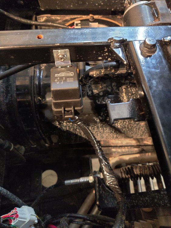

It was the relay.  I ended up buying a different one off of Amazon because it took scautoparts.com 9 days to ship the OEM relay at a cost of $42 with shipping.  Also, you cannot find that relay anywhere else on the web but scautoparts.
Heres a few pics of the new waterproof one at a cost of $10 and readily available on Amazon.  Also note that the original relay was mounted horizontally, which let's water in.  I mounted the new one vertically.
Here's a link if anyone needs it.
https://www.amazon.com/gp/aw/d/B08D8TSMFV?psc=1&ref=ppx_pop_mob_b_asin_image#aw-udpv3-customer-reviews_feature_div
Here are the connections I made in case anyone else does this.
Blue to red white
Black to green
Red to red
White to red black

7 hours ago, Ridge Runner said:
I think I see a fuel canister mounted on the frame rail.  Maybe the T-Boss and Outfitter aren’t the same machine?
Yep, that's the fuel filter canister you see in the last pic.  I'm unsure if the Outfitter is the same, hopefully someone will pop in and specify.  Do the above pics look anything like yours?
As far as the relay goes, the one I posted above I bet would work with yours.  A relay is a relay, you just have to match up the amperage.  The one from Amazon above is 30/40 amp so it could easily run a fuel pump, just have to make sure what each wire does before connecting.
