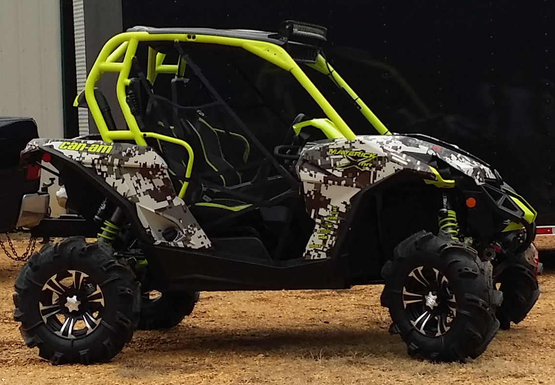

Just a photo of my Can Am 2015 Maverick 1000 XMR DPS Digi-Camo
By SpaceGhost
They will be coming off.
