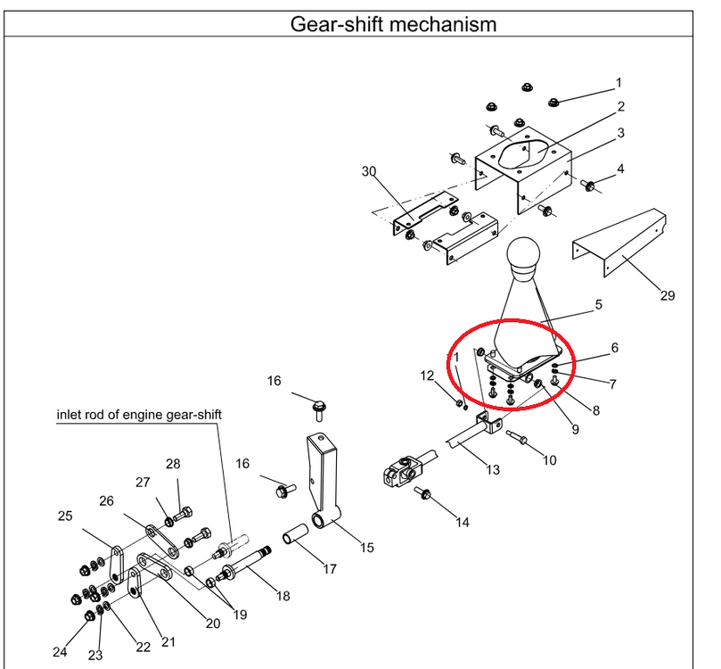

Turn out that the shifter bushing is bad.
It allows a lot of slop in the shifter in all directions. Plus it wont allow the shifter shaft to rotate when you move the shifter left and right.
Part number: d650.05.02.02.02
#9 on the picture.
