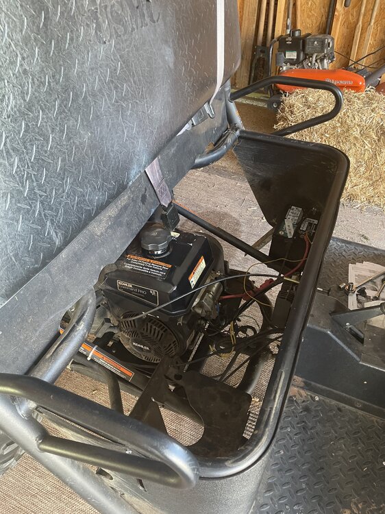

Some things to look at?
Do your headlites or dash lites come on?
If so then you may have a bad ground or bad hot connection, either at the battery or at the frame or starter connection. Assuming the battery is charged. Take the battery cables off and clean them then the other ends of the cables at the frame and starter and clean them also. You would be surprised how little corrosion it takes to reduce the voltage.
 If nothing comes on then I would think a fuse could be bad, or a worn or cut wire somewhere?
 Does the engine turn over by hand? Have you tried using the hand/rope starter to turn it over or start it.
 Is your switch ok? Do you get power at the starter from the switch? Starter may be bad? If you tried everything else maybe have a parts store check the starter?
