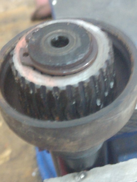

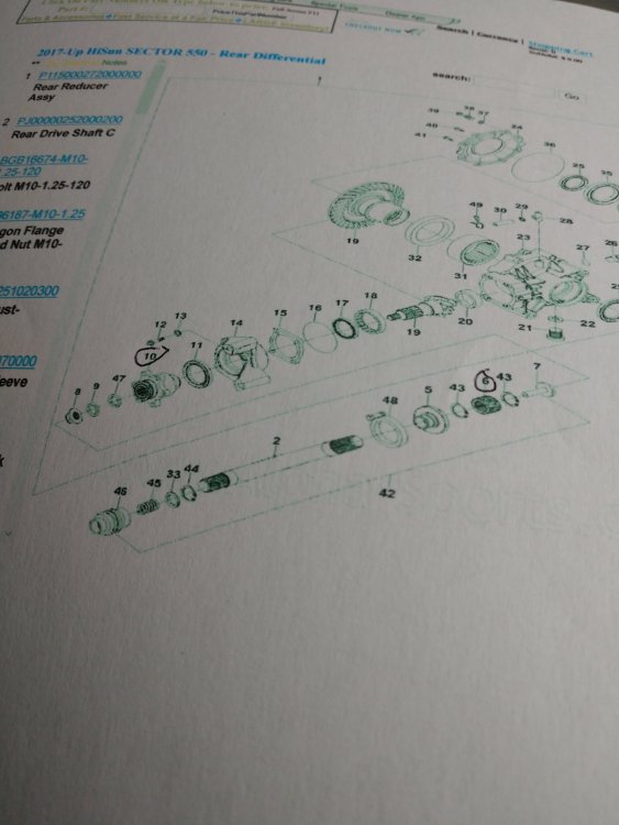

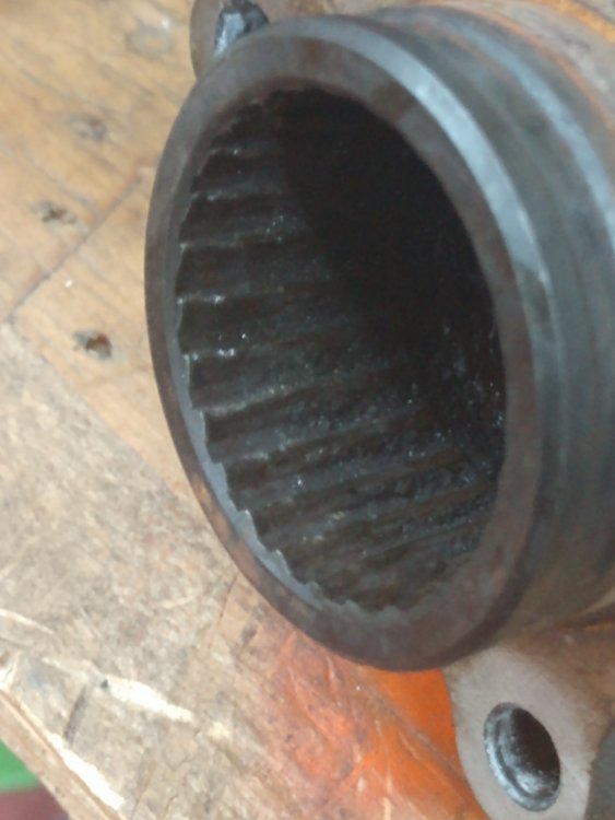

After talking it apart and looking at the diagram the factory had a compression spring inside my rear drive shaft connecting seat, which is number 10 on diagram. Should of been just a flat washer with a lock washer then nut.  Mine was nut flat washer and compression spring. The only compression spring used is supposed to be up front number 45.  But part 10 and 6 is on its way. Picture of diagram and parts destroyed.
