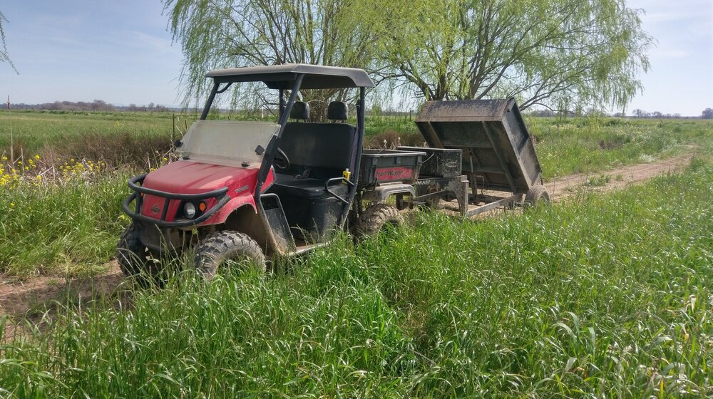

Here was mine. Workhorse, pulled that wagon loaded with nasty horse stall shavings and manure, every day for 8 years. Still going when I sold the ranch.
That’s an old Cushman dump trailer from a golf course, paid 200.00 at an auction, added the battery and hydraulic pump and a remote control to operate it.
They were both little tanks, to be honest…

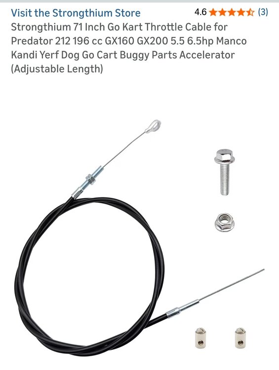

The throttle cable we bought on Amazon was a perfect replacement with plenty of extra length to ensure we had enough.
We installed it to mark where to cut the housing. Then pulled the cable out of the way to cut the housing only. They pushed the cable back thru and cut that separate. Works great and awesome to have the TW450 back out in the yard!
