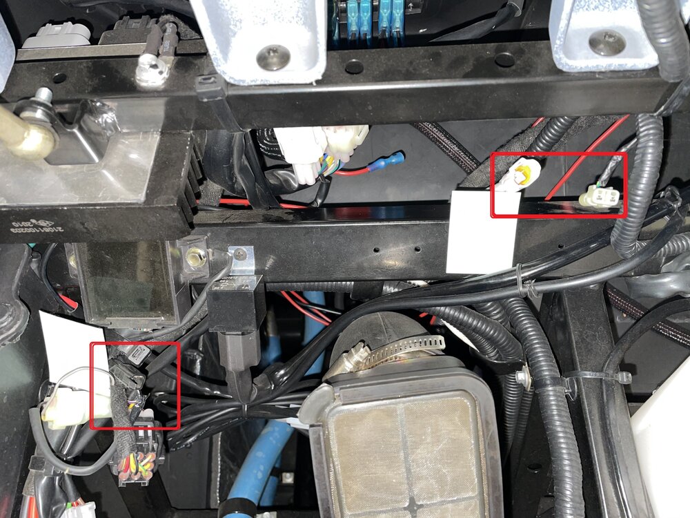

My Odes Dominator 800 bogs down when it gets to 25mph
My 2021 Odes Dominator 800 bogs down at 25mph and won’t go over that speed. I have changed the fuel pump and it still does the same, it runs and idles fine, it has great reverse speed, but it won’t accelerate past 25mph. Any Ideas?
Did you connect some disconnected lines under your hood? Sounds like your LSV connection. That is the LSV feature (low speed vehicle), for indoor use, training, youth, etc. Keep it unplugged for full speed. See picture. Red box on the LEFT.
