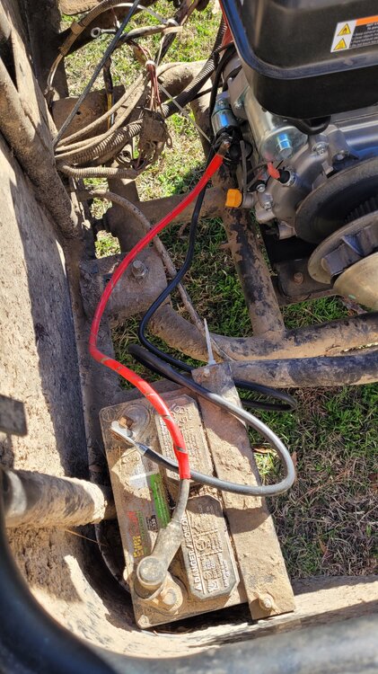

Well, my son pulled the motor and took it apart the other day. Now we can see exactly what's going on inside the original motor, Kohler ECH440.
Might not be able to tell exactly what happened. But definitely appears beyond repair!
So today, I bought the Harbor Freight, Predator 459cc 15.8hp motor to put on our Trailmaster TW450. Same shaft diameter and length, a little more HP. Hoping to have this thing running again soon!
If y'all have any tips/tricks/advice on how to proceed with this motor swap, I'd greatly appreciate it! Especially if y'all know of an easy way to get the stock ignition to work with the starter on this predator motor, that would be awesome!
We've got a simple "battery-to-solenoid" connection to use the electric start on the Predator motor. But what I really need help with now is figuring out how to get the headlights and maybe even the stock ignition back working again.
Does anyone know how to get an after-market motor connected to the stock wiring for ignition, lights, acc, etc.? The little copper solenoid terminals on the predator already have several things connected to it. Any wiring advice would be greatly appreciated! Thank y'all!
