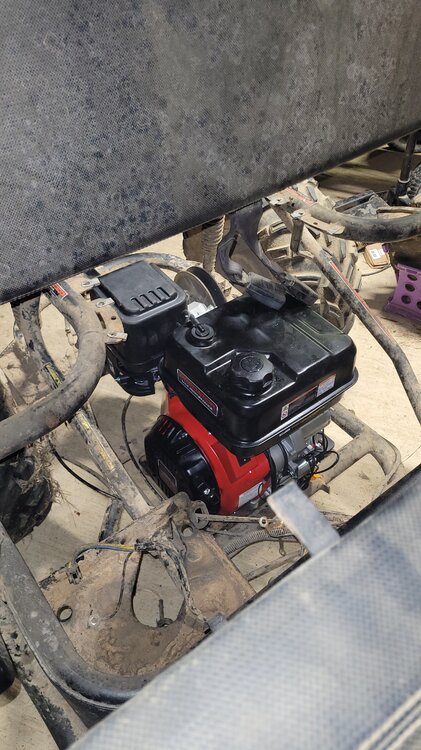

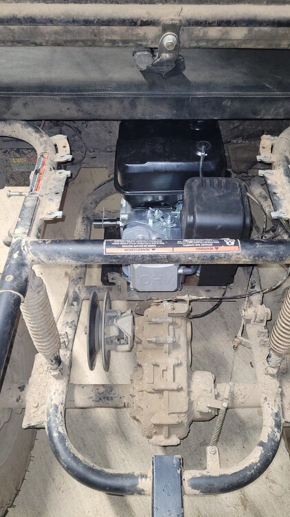

We've got the old Kohler motor out and the new Predator 459cc in!

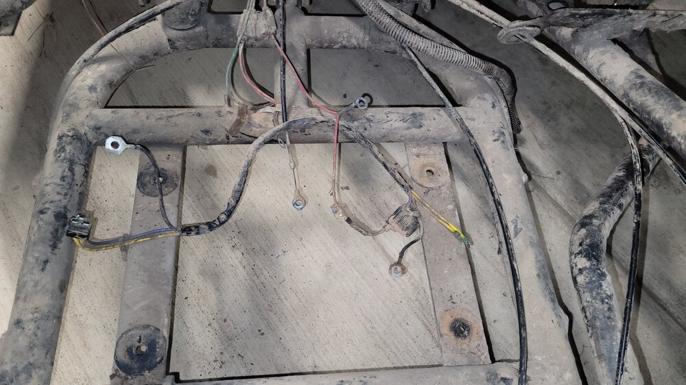

But before we put the motor in there. I took some pics of the old wires. I'm hoping y'all can help me figure out what all these are for and what we need to keep.
There are a lot of inline fuses. And all the labels we can read say "12v pos" or "regulator/rectifier."
Main thing I'm looking for:
1. Wires to connect the stock ignition to the starter on the new motor
2. Wires for the headlights
If anyone can help me identify what all these wires are for, I'd appreciate the help!
Have you tried going to Landmasters web site and seeing if the diagrams are there. I know they go back in years a bit but not sure how far they go.
 On my newer '22 L5W they have everything for it. The wiring, chassis, motor, etc. that your able to gander at.
Other then that you'll probably have to follow the wires from the ends to the dash and see where they lead. You said you took pictures so you should be able to narrow down where the wires came from on the old engine and transpose those to the new engine. Different motors but still have the same connections.
