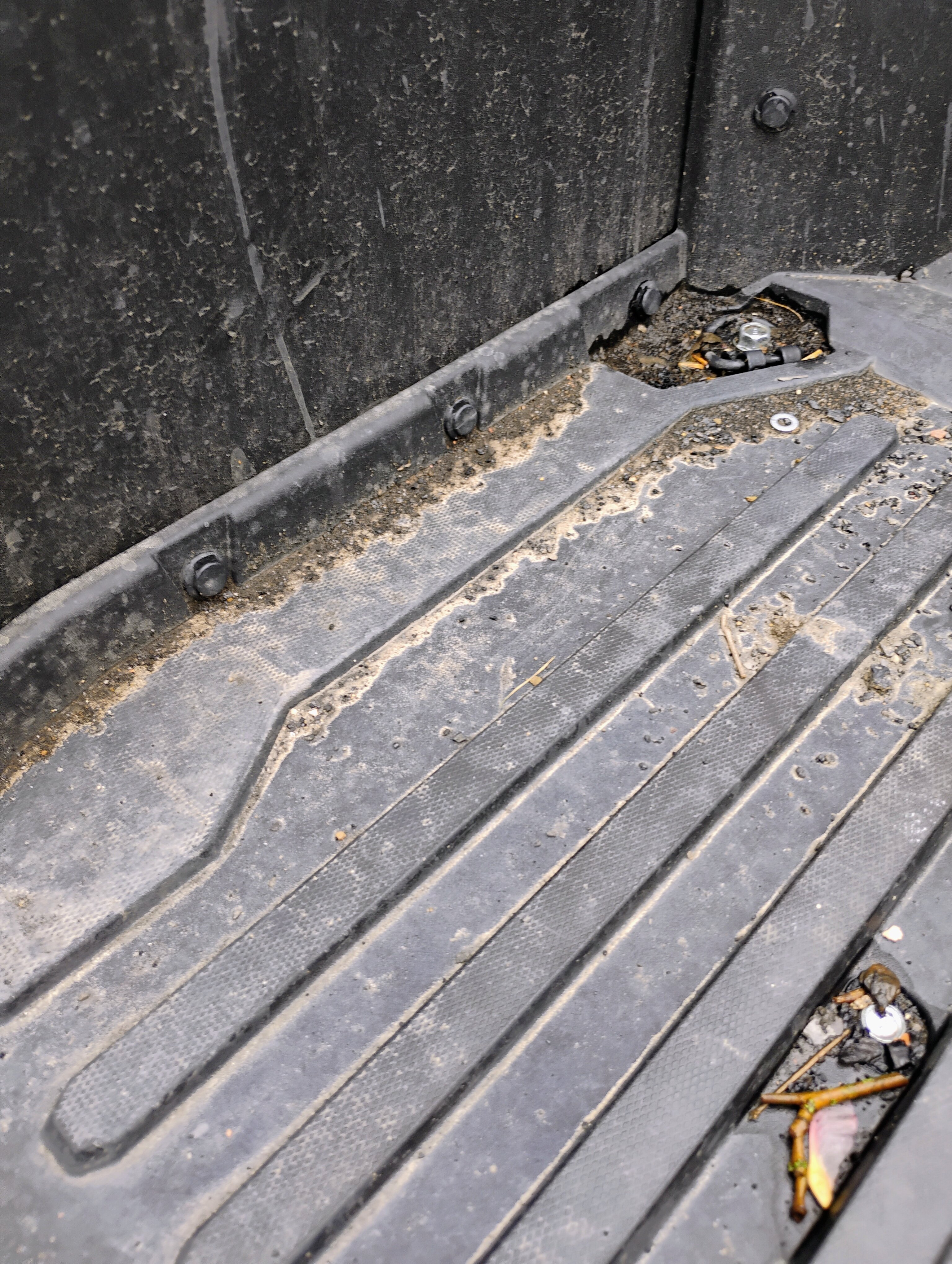

These little guys on the edges of the bed. Sorry if the photo isn't super clear...oh and it's kinda dirty 😅.
I'm picking up what you're saying though. I think if I cover those with masking tape and spray it down with bed liner it should work. I did some digging on it and so far it seems like a good solution for helping haul stuff.

Okay I see what you mean. In your case I would tape them off before spraying so you could still have access. Another great option is to go to tractor supply and buy one 6'x4' horse mat. I believe there are two thicknesses. Use cardboard to complete a template and cut it to fit on the floor of your bed. It will significantly protect the bed. It may be a better option in your case. A good impact socket set with breaker bars and a hijack type jack is always a good thing to have.
Horse mats!? I can't believe I didn't think of that! That an awesome solution.😁
