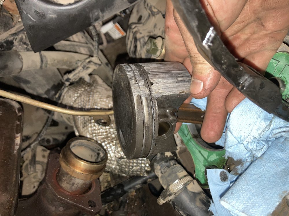

No progress yet. I'll take a look at the fuel pressure. I watched it once I removed the fuel line from the injector. It looked good, but not a quantitative measurement. I borrowed a compression test gauge from a buddy and it was 25-30. I went ahead and adjusted the valves last night, but no luck.  I'll definitely look at the fuel pressure and keep y'all update with any progress, or lack there of.
An update. The fuel pressure was good Was good but I went ahead. So I dived into taking the engine apart.
This is what I found. This doesn’t look good to me so I’ll be changing the piston.  Surprising, the cylinder looked alright, but I’ll have it honed at a shop. I’m going to look at the pistons too. I think I’m on the right track, hopefully.

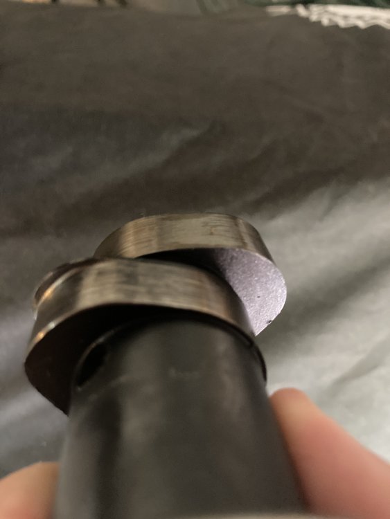

So I changed out the piston and went ahead and got a new cylinder. There were some vertical marks and I was advised since I had it all apart to go ahead and replace the worn/damaged ones. I went ahead and replaced the camshaft too. There was quite a bit of wear on the exhaust lobe. I went ahead and looLed at valves and everything was great. Put everything back together and cranked it this afternoon and sounds better then it did when it was running.
