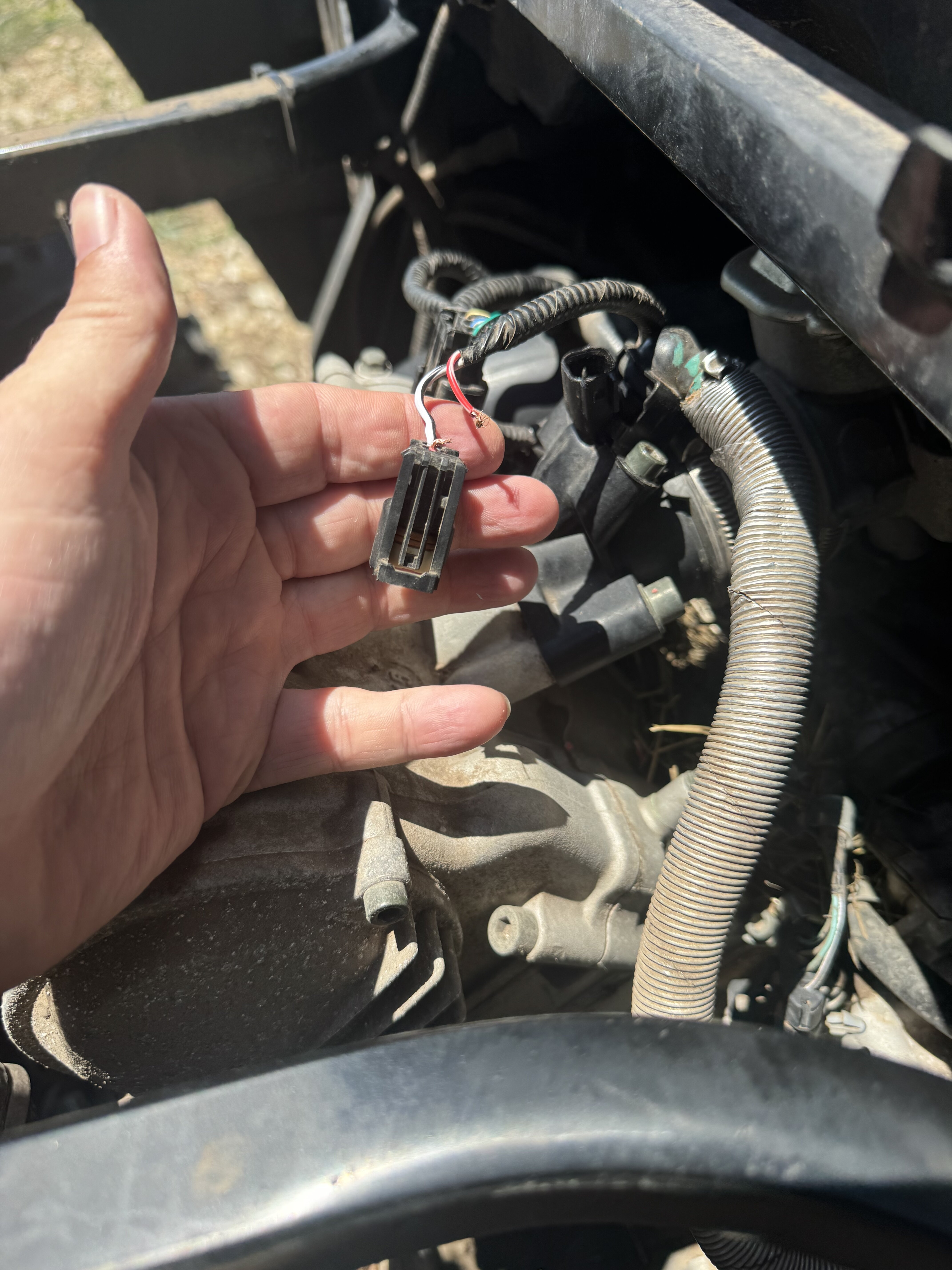

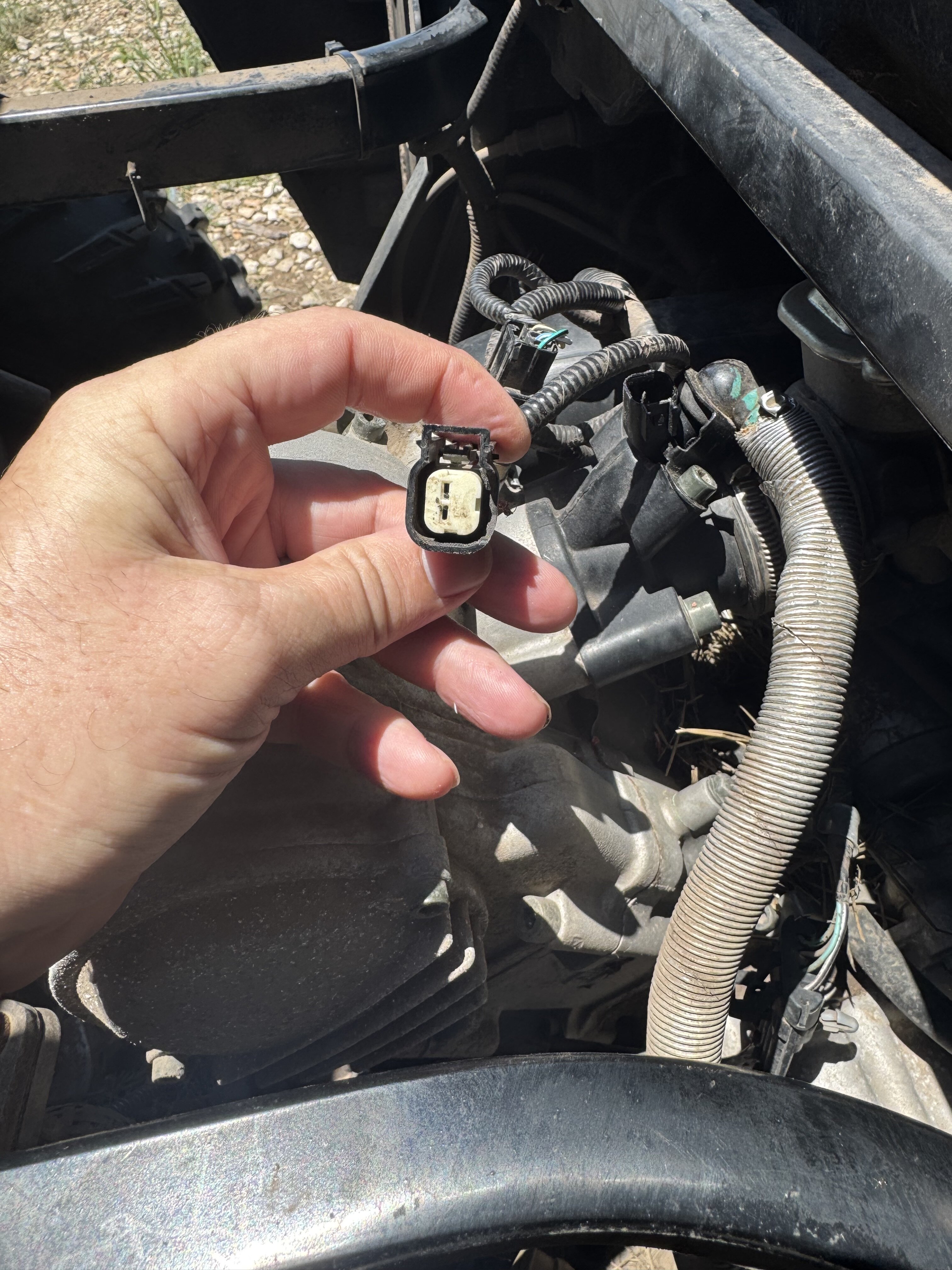

If there isn't enough wire left in the connector to solder it to the red wire end, you might try -carefully- using a Dremel tool or similar to trim back the plastic connector housing around the red wire, just enough to be able to solder it back onto the wire itself.  That's what I would do since there seems to be little info available about the injector connector itself.    You may have to buy the entire wiring loom with the injector connector included.
Not sure this pic is your particular model or part number for the EFI Cable,  but $120 bucks is pretty stiff price to pay for a chewed wire!!
