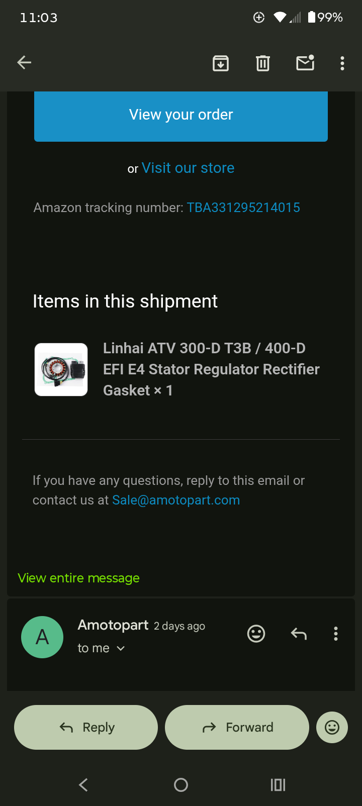

So yes, I had a guy locally who works on all different types of motors, and he found a stator and voltage regulator and swapped them out.  UTV starts right up and runs as it should but the gasket that came with the stator was the wrong size, so he used liquid gasket and I think he missed a spot or a bolt need tightened to stop a slow oil drip.  The part was found somehow through amotopart.com.  It seemed a little sketchy working around the site and tracking process but turned out as legitimate as I could expect.
All that said, when I begin driving and using lights the low battery warning starts flashing but when I stop and shut everything off it goes away....everything I am reading is suggesting corroded wires(which I don't see), loose connections (which I don't see) or a battery that is unable to receive charge.  So, I am currently onto the next thing which is a battery compatible as the one in the Buck when I bought it according to google is not the correct type.
Ok, sounds like the Linhai 400 equivalent is compatible then. They have a slightly different cover design with a bulge at the top which is why the gasket doesn't work.
