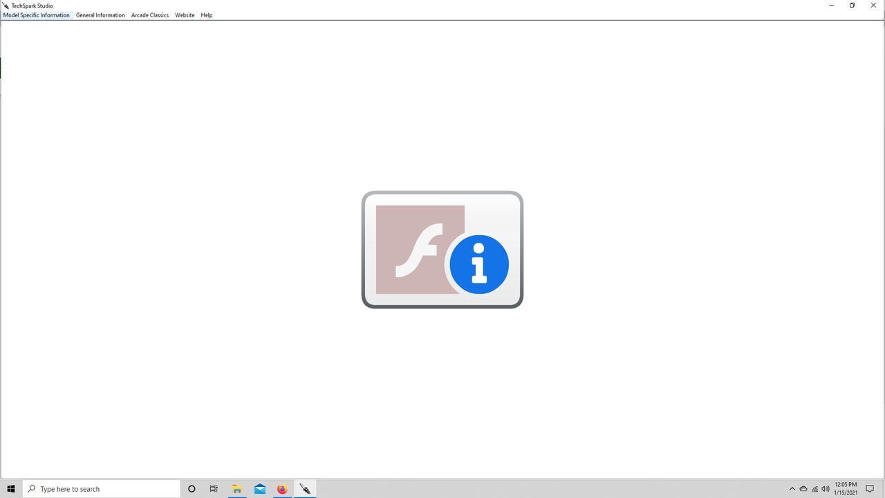

I use a tech spark manual that is on a CD for my mule, well as of a few days Adobe Flash is no longer supported and my CD manual wouldn't work. If you have a Techspark CD repair manual  and you get this screen when you go to the manual,

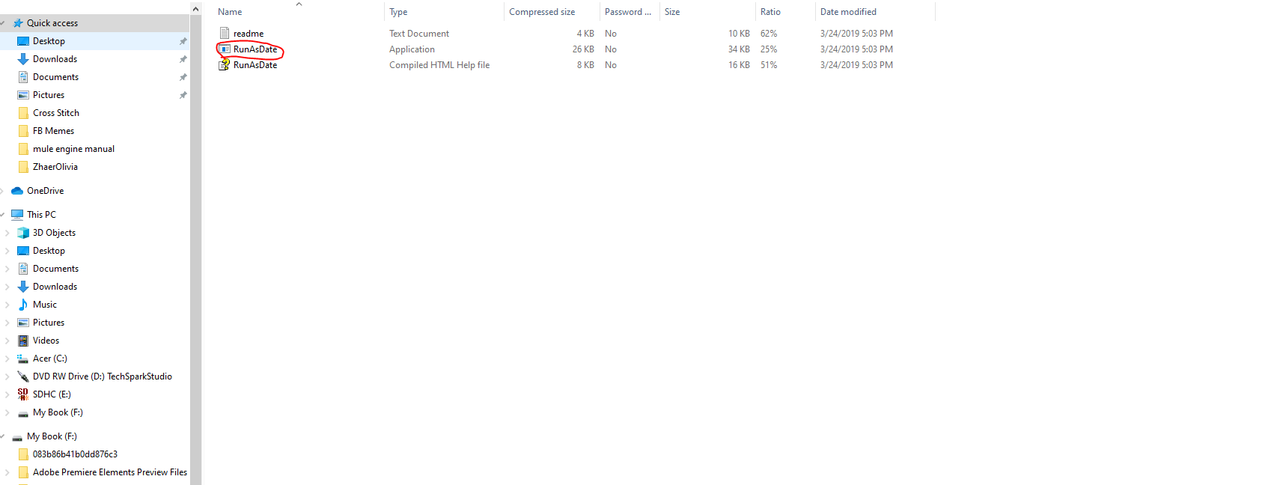

Download this: https://www.nirsoft.net/utils/runasdate.zip  it allows you to run a specific application on your PC  before a certain date (think of, going back in time)
Now, after you download it, you should be to this point click on what i have circled in red
