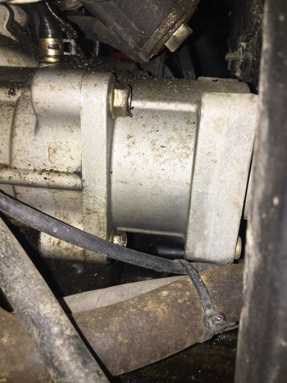

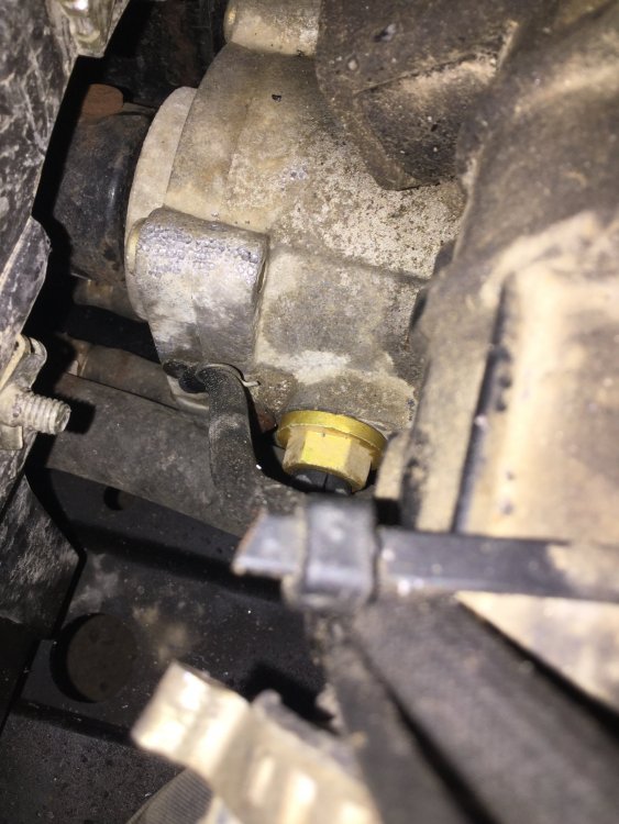

The switch works, fuse are good, the light comes on to show 4wd is on.  No noise heard on the front when the switch is pressed (unlike the unlock button when pressed for the rear 2wd). I have power all the way to the block on the front differential so it tells me there is the problem. Thoughts? Does it make sense that could be the cause,?
