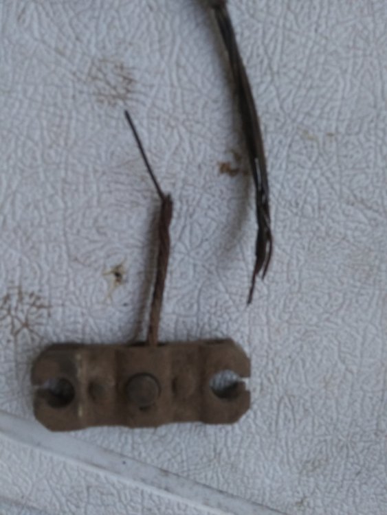

I have alot of issues with this machine that I'm trying to figure out and fix. Today when I was fixing the shifter I see this cable connection that is not connected to anything. I looked and can't find where it might need to be. Any ideas would be greatfull.
