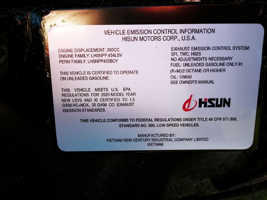

There are only a handful of manufacturers that actually make the parts for these things.
My "Coleman" Outfitter 400 is a re-branded Hisun HS400 , actually made by the  Vietnam New Century Industrial Company Limited;
I have mixed emotions about that a I spent 13 months in Vietnam in 1967--it sucked...

Cliffyk, did you do an upper end repair on your HS400 due to smoke?  I have an intermittent smoking problem with mine. Sometimes it’s good and other times it’s terrible.  I suspect the oil ring is sticking as compression appears good wet & dry.
Steve,
I dont believe cliffy is around posting much anymore as I believe he sold his SxS due to health issues.
Does your HS400 smoke under specific conditions? heavy load, startup, etc? or just totally random?
If its sometimes on startup you may have a dripping fuel injector. If its more random I would lean towards the sticking ring theory.
If you think it might be a sticking ring due to sludge/carbon I have had good luck on an older automotive engine using a product called Kreen. Its made by the makers of Kroil, and you can only order it off their website. Anyway the trick is to put about an ounce down the spark plug hole and let it sit for a day or so. It will slowly drip past the rings and clean out carbon & sludge as it goes. Once the day is up crank the motor over with the plug out to get any remaining liquid out, and then reinstall and start it up. You want to do an oil change afterwards as it is a pretty strong commercial solvent. Might be worth trying before doing a whole top end teardown anyway.
