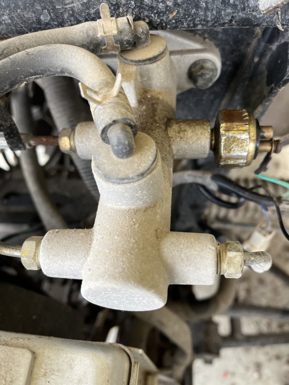

I'm having another issue with my 2019 Buck 400. When I push in on the brake and turn the ignition to start nothing happens. If I pump the brake several times it will start right up.  Does anybody know where the relat is that prevents it from starting until you apply the brake? I think it must be loose or something like that.
Thanks for your help.
I have a 2019 T-boss 410, so it's not exactly the same. However, there's a switch on the brake assembly (usually under the hood) that I needed to adjust, since it wouldn't always start. I would step on the brake, and hit the key, and nothing. I located the switch and adjusted it, now no similar problems. The best thing I can suggest is to follow the brake linkage until you locate that switch. It's the same switch for the brake lights.

Did you locate the brake switch on the Massimo Buck 400? I am having the same problem. I can’t find a switch following the brake linkage. How ever there is a pressure switch on master cylinder. Could this be my problem?
