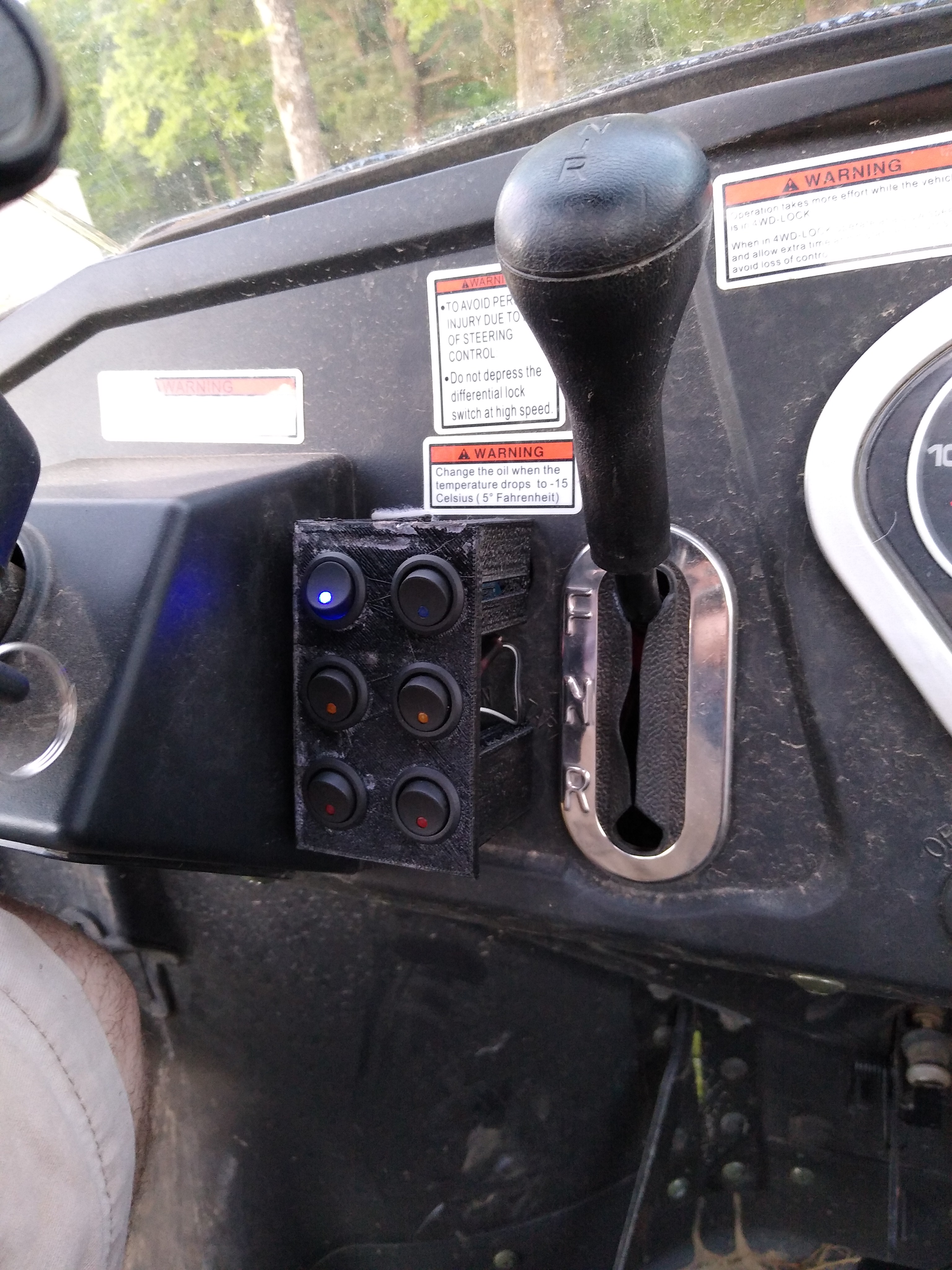

Here is a couple more 3d printed goodies, a plate that uses the existing knockouts in the dash plus some Velcro pads to mount some rocker switches for a no-drill solution, and a mount for a slow moving vehicle placard on the tailgate.
