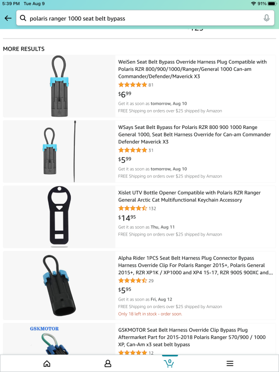

Here is what I was going to use on Polaris but didn’t purchase. I don’t know if this would work on Hisun or if the plug any is like Polaris. Don’t know where to plug it in if is
Link to comment
Share on other sites
Something like that will work i you can find the right size plug. They are litterally just a matching plug with a wire that runs between the two terminal also. You could do the same thing with a straightened paperclip and some electrical tape if you want.
The plug is under where the seat belt female part is, you can see the wires running down into the seat gap. Flip up the bed and follow the wires coming down from it.

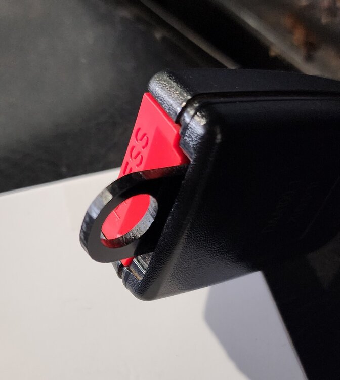

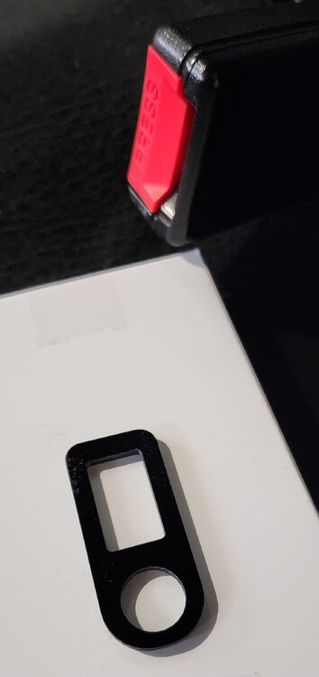

On 8/10/2022 at 8:22 AM, Roadstar515 said:
So do you think this will work? I guess it’s cheap enough to try
Just latched up with new seat belt (let’s call it a key), and it fits just like seat belt lock. Just fyi, you only need drivers side to deactivate system cause passenger side is a different size and not needed.
thanks again for the lead on this
