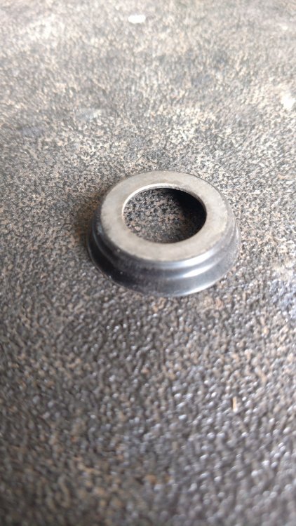

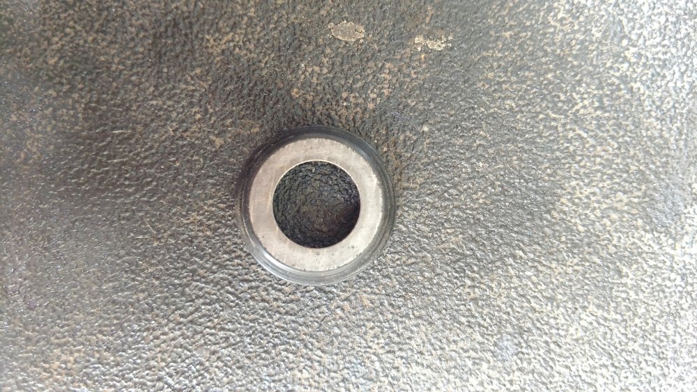

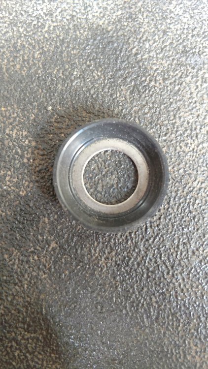

Hi we sell heim joint seals. We have different sizes. With this type of seal it should keep the joint clean for a long time.You will have to slide them in the sides. No grease, it does attract dirt and sand into the heim joint. We are carrying a much better quality heim like the one you purchased at a better price. We are carrying UHMW bushings for the rear of all joyners.
Thanks, Rick
