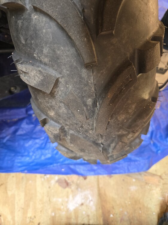

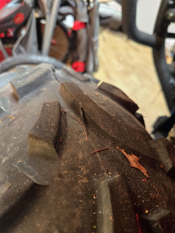

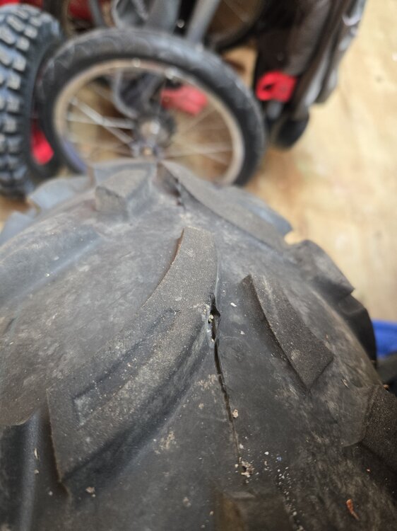

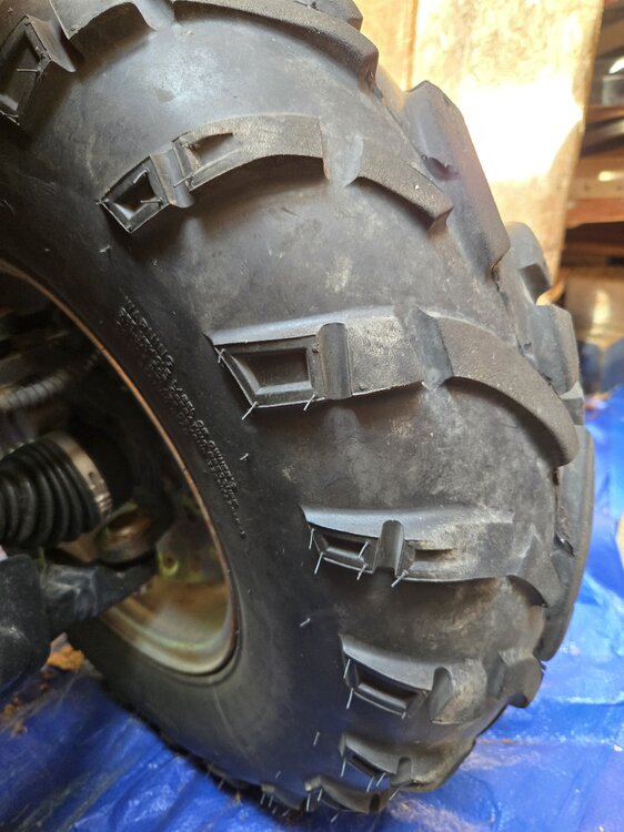

Does anyone know why the middle of my front tires are wearing too fast?  I just checked the pressures, and they were at 24psi.  The manual says 10psi. Could that be the reason, but why aren't the rear tires showing excessive wear?  I've attached photos.
Any suggestions would be appreciated.
John
You've answered your own question. The pressure is way too high. It's only running on that portion of the tire and the fronts wear faster than the rears because they take a beating from steering, especially on hard pavement. You must also have a very hard ride. Get the pressure down to the recommended level.
