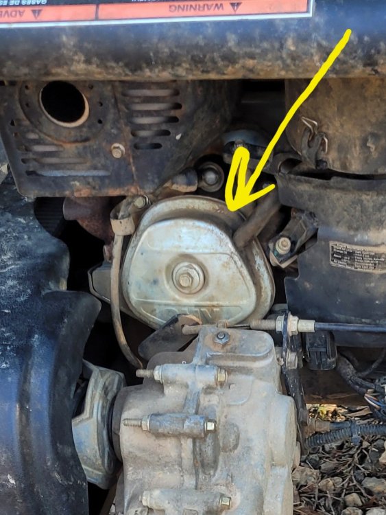

Ok...
So I've been trying to take my UTV apart to get to the starter. I've been working on and off for 3 days! But I've hit a wall.
I have a Kohler CH440 motor. The starter is inside. I've gotten all the screws off the cover. I just can't get it off without moving the motor some.
So here's my question... Is there some way to raise the motor just a few inches so I can pull the cover off the side?
Any advice would be greatly appreciated...
Link to comment
Share on other sites
I finally got the shroud off and the old starter out. Tried to put the new starter in... don't fit. The casing around the top of the starter (the part that contacts the flywheel) is too small. But the shaft inside the starter is too long to swap the casing that covers the starter.
What can I do now?
If I have to order another starter... how can I make sure I get the right one?

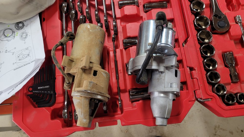

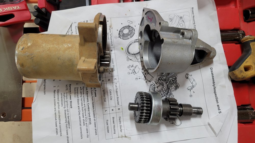

I said I was going to explain my starter swap, so here it goes...
First off the top half of the starter would not fit. Whatever I bought (cheapest replacement on eBay $38) was too small up top and didn't line up with the 2 screw holes.
I tried putting the old cover on top. But the new bendix (all the spring loaded gears that extend to contact the flywheel) was just a little bit taller than the old bendix and wouldn't fit without some heavy-duty metal cutting or drilling. Fortunately, the gear on the old bendix fit on top of the new starter. So I ended up installing and new starter (with new solenoid) but with the old bendix and old cover on top.
(This pic is all the leftover parts. The new stuff was already installed when I took this picture.)
After all this work was done, I realized the easiest way to do this job would have been to undo all the motor mounts on the bottom and raise the motor just an inch or so. I could have easily removed the 4 or 5 screws holding the shroud over flywheel and all that. I would not have had to remove the heat shields, exhaust, and all the other stuff I didn't need to take off. So the starter works better now but is not 100%. It still makes that hard "klinking" sound sometimes without moving the motor at all. Here's a pic of the flywheel where the starter is supposed to be...

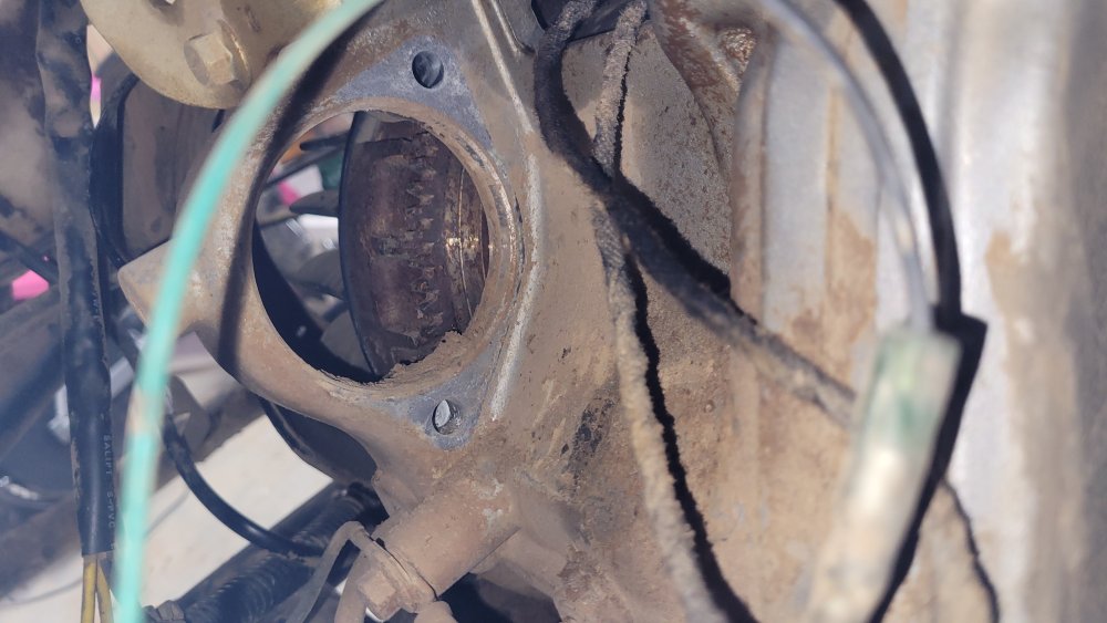

You can see how much dirt has gotten in there with normal daily use on our property. The flywheel looks rusty and corroded. There is dirt built up right where the bendix makes contact with the flywheel.
So what could be causing my starting issues? Should I try a battery with more cranking amps? Should I try a new starter with new bendix and all? I've gone through 4 or 5 pull start cords over the last 4 months. They keep breaking! Could there be resistance somewhere else that's giving my starter such a hard time??
I would love to hear your thoughts...

Don't have a lot of experience with Kohler, but an engine is an engine and they mostly work the same, I am concerned after the starter problem you state that the rope keeps breaking. That should not be happening unless the engine is hard cranking. By the way, congrtaulations on the starter work. Shows you are thinking and making it work for you. I would first want to adjust the valves on that engine. most smallengines have some sort of automatic decompression to allow the engine to crank easier and get up to speed. This is usually accomplished by the adjustment on the exhaust valve. They have an internal component that temporarily holds the valve open for just a short while to relieve the compression. It can be off by just thousands of an inch and not open the valve Also it can be too tight and bend a pushrod.  You can find youtube videos of how to adjust the valves. Make sure you understand the procedure and go easy. Remember not too tight. If the spec is .00-4 to .0006 set it on 5. After closing it up, with the sparkplug out turn the engine over by hand. If it seems to bind you have the valves too tight. Or you can take it to a local shop and have them adjust it for you. This is an important part of the maintenance and should be done every 500 hrs at least. This could also have been hard on the starter making it fail. I'm going to attach a small handbook for that engine with some starting tips for you to go over. After you get this machine working, remember to never crank one of these small starters more than 10 seconds without letting it cool for a minute. they burn up easily.OM_CMD_PRO_Hor_17 590 11_REV_B_English.pdf

I'm sorry. I didn't inspect it like I should have when I had it apart.
But looking at the full res photo on my phone, I don't see a crack. Its just dirty!
Plus, the flywheel resonates nicely when the starter hits it just right. I don't think a cracked flywheel would do that. (Or maybe it would... I don't know)
