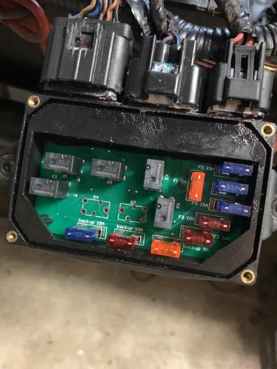

Found the fuse box, thanks, no blown fuse. Connections appear good, but that wouldn’t explain no spark anyhow.  There are five fuses three spare fuses and five mini relays that are unrepairable wish I knew how to test them anyhow there are other things to test thank you

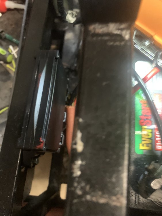

O'k since last post I let it set, went on a vacation, got busy with other things.  I tried everyones suggestions..no luck. Also it DOES have a fuse/relay box under the drivers seat. You remove the seat AND the bolt down panel under the seat and the box (its small) is bolted to the frame. It's maybe 4" x 2.5" and 3-4 inch thick max! Front and back is screwed down for moisture protection. No fuses blown. there are 5 little relays soldered in.
Tested the connector at pump, there are 12volts to the pump with switch on and something like 4-5 volts in the 4 pole connector to the fuel gauge (it works). There is no ground to the pump. Pump is supposed to cycle 2-3 seconds when you turn key on...I traced the ground wire over the engine, opening the harness all the way to the fuse/relay panel thru 2-3 plug connectors with the wire changing colors 3 times!! There are no branches in the wire. I have continuity all the way from the fuel pump to a relay in the box. Removed fuel pump and it runs on the bench. Re-installed pump, attached jumper wire from ground to frame and it runs. So ground IS the problem but why??  Also still no spark to EITHER plug.
Replaced the fuse/relay box with new...still no fuel ground or spark. Oh, new battery as old one was bad. Thinking new ECU? Its a DOLPHI MT05, used on over 50 UTV/moptorcycles........FINALLY a question. As this ECU is used on many different makes/models does it have to be programed/flashed for my specific machine? If so any suggestions would be appreciated.
