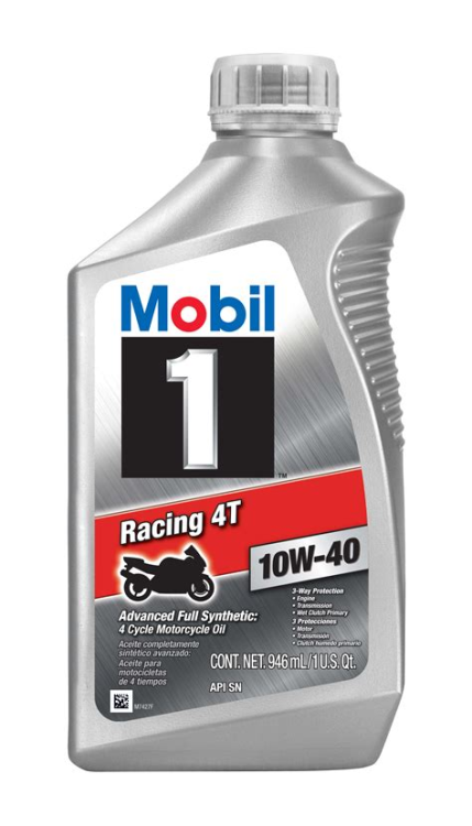

I used Mobil 1 4T-10w-40 when I owned a Coleman (Hisun).  There was a noticeable improvement in the shifter and sound of the machine.
