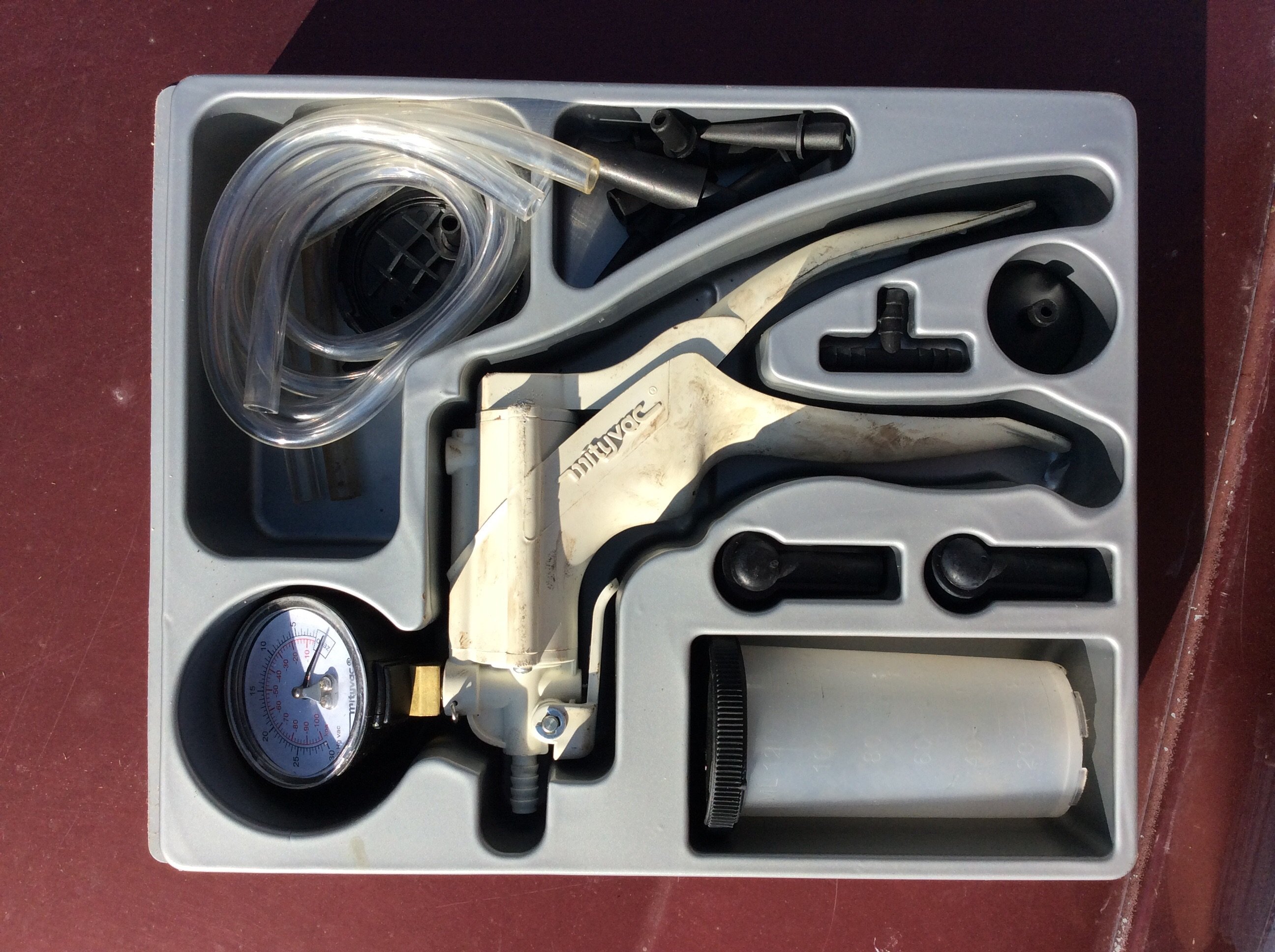

So if you have not tried a vacuum pump do so before replacing your master cylinders ,  I have found over the last few years with the new brake systems this simple machine is a lifesend. The one I have is made by mightyvac and was about 50$ at my local auto parts store, as long as your master cylinder is full it will pull out all the air in a few minutes.
