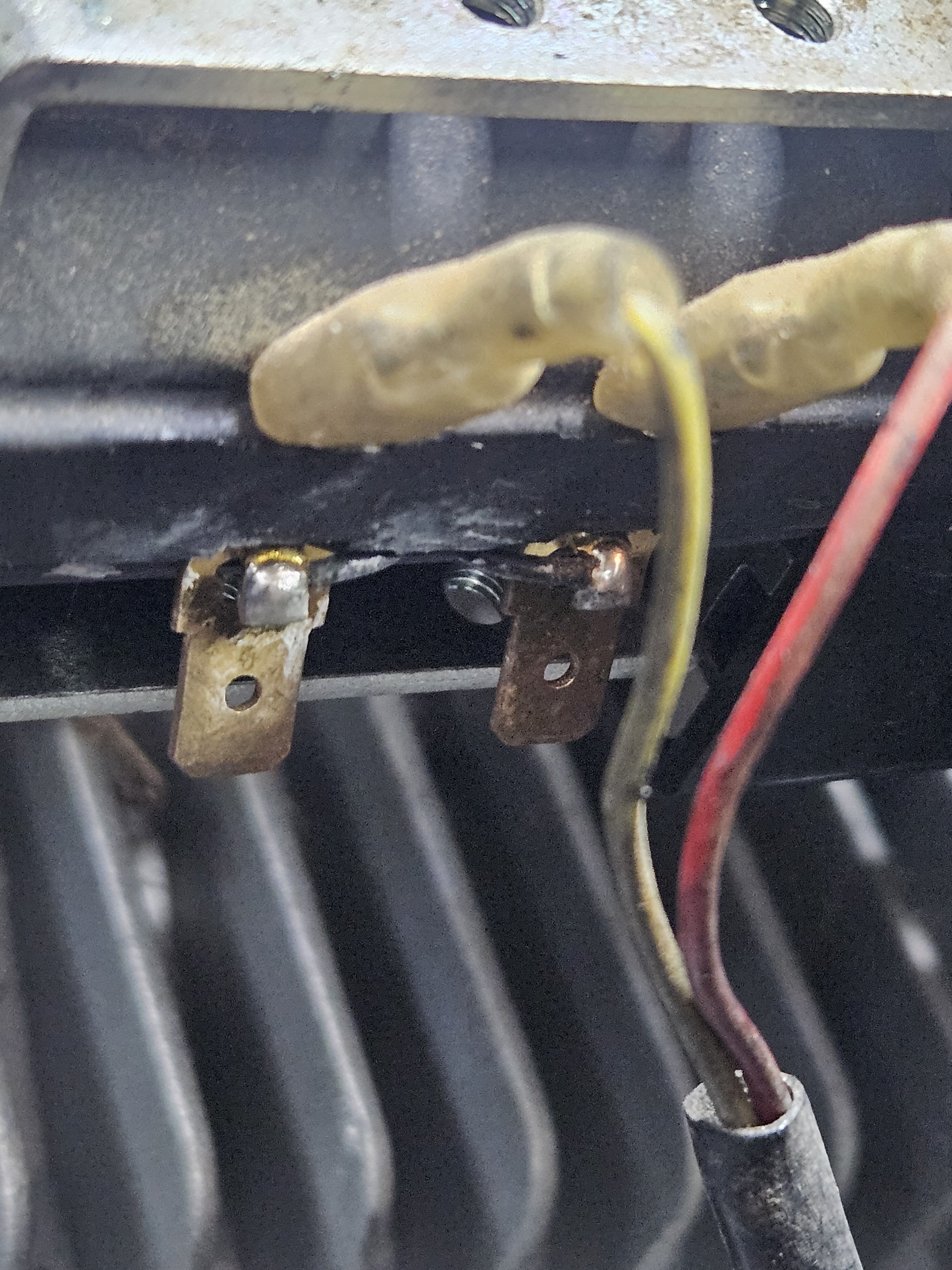

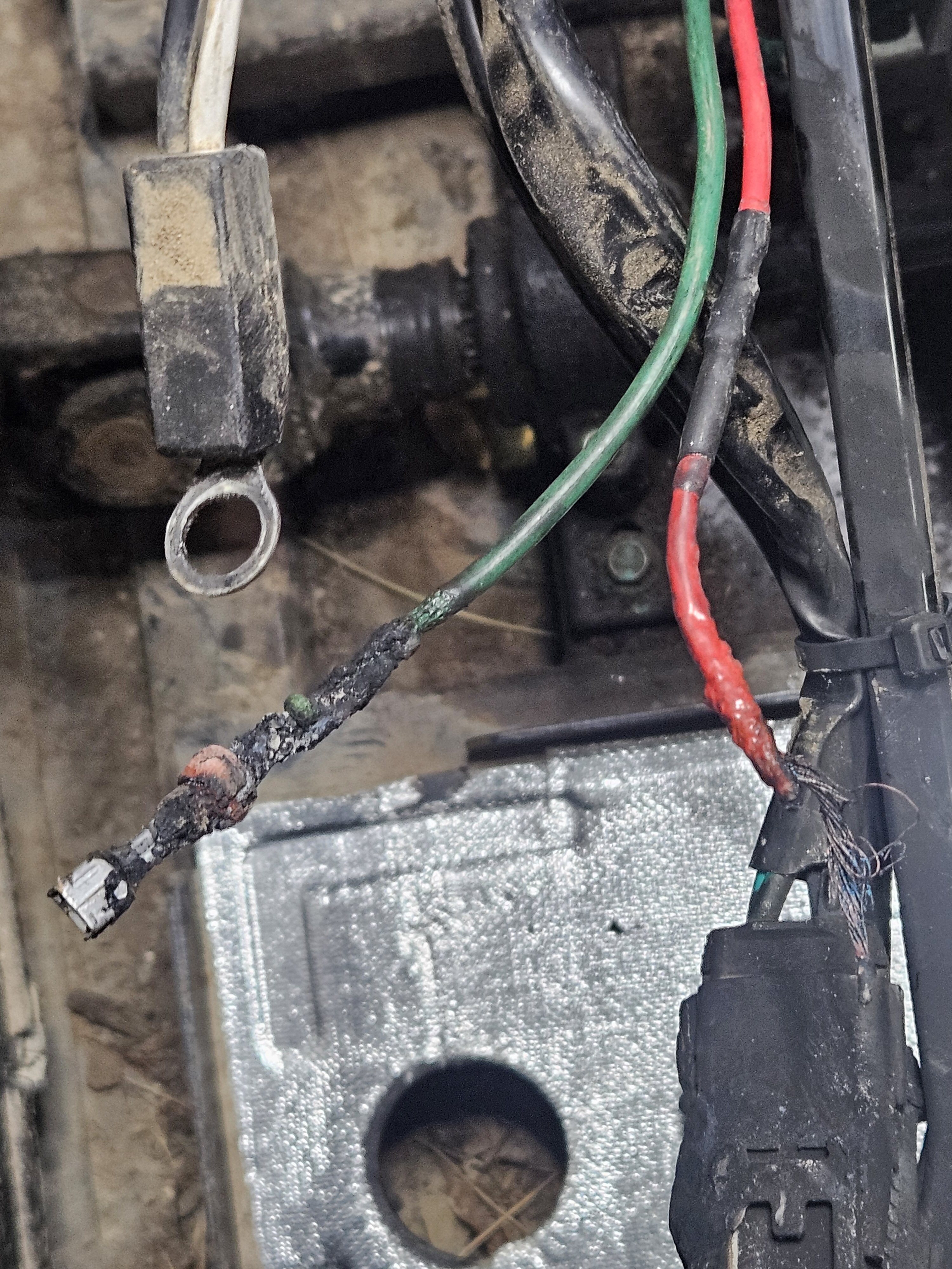

I purchased my Hisun Sector E1 three years ago.  I think there are a few hundred miles on it, and lots of charging.  A couple of weeks ago it started sputtering a lot, not charging fully, and discharging fast.  I took a look at the battery compartment under the seat, and noticed this (picture below) which certainly explains a lot!
Questions:
1) Where are those disconnected and corroded wires suppose to go?
2) I took out half the batteries thinking they might be in bad shape, but measured 5.4v on all of them, which doesn't seem bad considering they probably haven't been charging for a while.  Do you think I should replace them all at this point (after three years), or just fix the wiring (although I'm not sure what caused that to happen), or they may still be perfectly good?  I certainly don't want to put them all back (as I mentioned I removed four out of the eight only to have to remove them again if they are not in great shape.
3) If I do replace them, I noticed there are much cheaper options on Amazon for AGM 6v batteries (Weize GC2 is one option) that are the same size and slightly higher AH than the original Discovery ones.  Any thoughts about going with these?  I know a lot of folks replaced the AGM with lithuim, but not sure I want to go through the hassle of also replacing the onboard charger, etc.  I fine with AGM and getting a few years out of them.

Funny enough, on mine that green wire terminates in a connection fitting but isn't actually connected to anything.  The red wire certainly looks bad. On the wiring diagram there aren't a lot of all green wires and my best guess is that is supposed to be connected a charging interlock, while the red wire isn't part of that so it is something else. I might point out that I just verified that, for better or worse, my E1 will actually move with the cord connected, so apparently I don't have that interlock and things work just fine without it. I don't see how the batteries themselves could be at fault for the burned wires problem. Maybe try splicing the red wire (which already looks like it's been spliced before) and leave the green disconnected? I can't tell from the picture if it looks like the red and green wires used to be somehow connected, which I don't think are supposed to be. Of course, you're going to have to put the four batteries you removed back in to test it since all eight Discovers are required to make 48V.

Looking again, it looks like the red wire was attached to a positive post of one of the batteries.  Like you, the green wire has a connector, but I couldn't find any fitting that it was connected to!  Green color often means ground, so thought it should be somewhere to the chassis or battery negative terminal, but could not find anywhere where it was connected to.

I do have the red wire and it is connected directly to a positive terminal, but it looks like it becomes part of a bundle along with the white and black wires that runs forward. So what I see on mine is slightly different than what I can see from that picture but maybe it's just the aspect. At any rate I would definitely fix that.

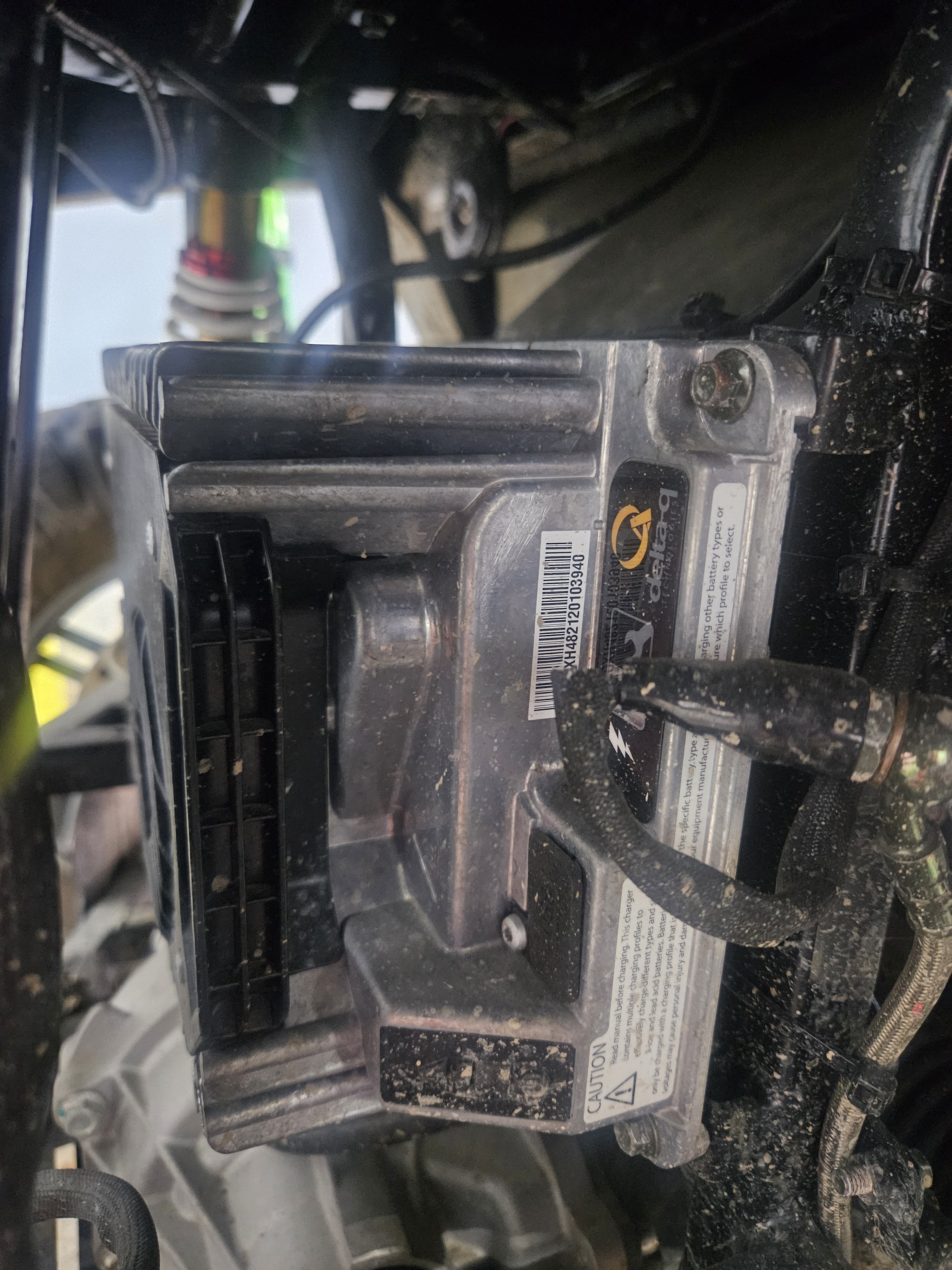

I am assuming your E1 has the Delta-Q IC1200. I think more recently they might have changed makers, but I'm not sure and I think yours is probably old enough. Mine is a 2020 model. It's easy enough to just look under the driver's front wheel well and see it in the center of the UTV.
The Delta-Q website looks like it has been updated with more lithium battery support than when I did the conversion, so that's good. Let me just give you links so it's coming from the official source:
https://support.delta-q.com/hc/en-us/articles/360016475772-Changing-Algorithms-on-IC-Series-Chargers
https://support.delta-q.com/hc/en-us/articles/14188856858893-Choosing-an-Algorithm-for-a-Lithium-Battery
https://support.delta-q.com/hc/en-us/articles/360015622651-Which-Algorithm-Charge-profile-should-I-use-for-my-battery
https://support.delta-q.com/hc/en-us/articles/360015622311-Download-Algorithms-for-IC-Series-Chargers
53 minutes ago, gridlock said:
Thank you!
This it?  I see it's a Delta, but don't see a model #.
Yep. That's it. They have pictures on their website, but that's what that is.

P.S. I do wish I understood what that green wire is for! :)  I hate to have that just floating in there.

I feel fairly certain that green wire is the charging interlock. For whatever reason it wasn't required on ours. Probably a country specific thing, like the "big red button" to disconnect the batteries that apparently the UK version has that mine doesn't in the US.

Green is definitely charge interlock. Gives a signal to the sevcon Red is the + from the charger, if its shorted that may well have damaged the charger. If there is no fuse on that end of the cable there is no other protection to the charger. Hopefully its internal protection will have worked, If it wasnt in use then the damage will be back to the main pack, those + leads to the pack will require replacement. As part of that I would suggest using a maxi fue the larger blades mean they do not get as hot when charging. DO NOT SOLDER. Only crimp, a soldered connection if hot will fall apart and can short, The most common fault like that is a battery screw being loose causing the lug to get hot and the solder melt. Always crimp.

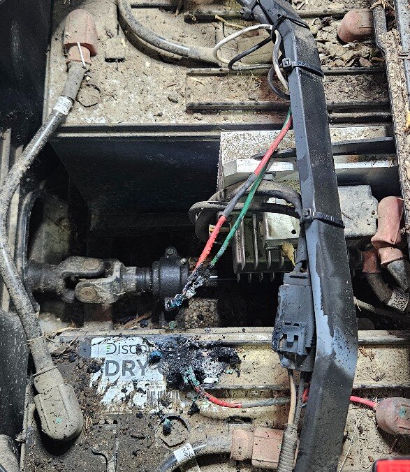

I got all the batteries and supplies, removed the rest of the old batteries, cleaned every out (unbelievable amount of dirt, gravel, leaves, etc.!) and ready to start installing.

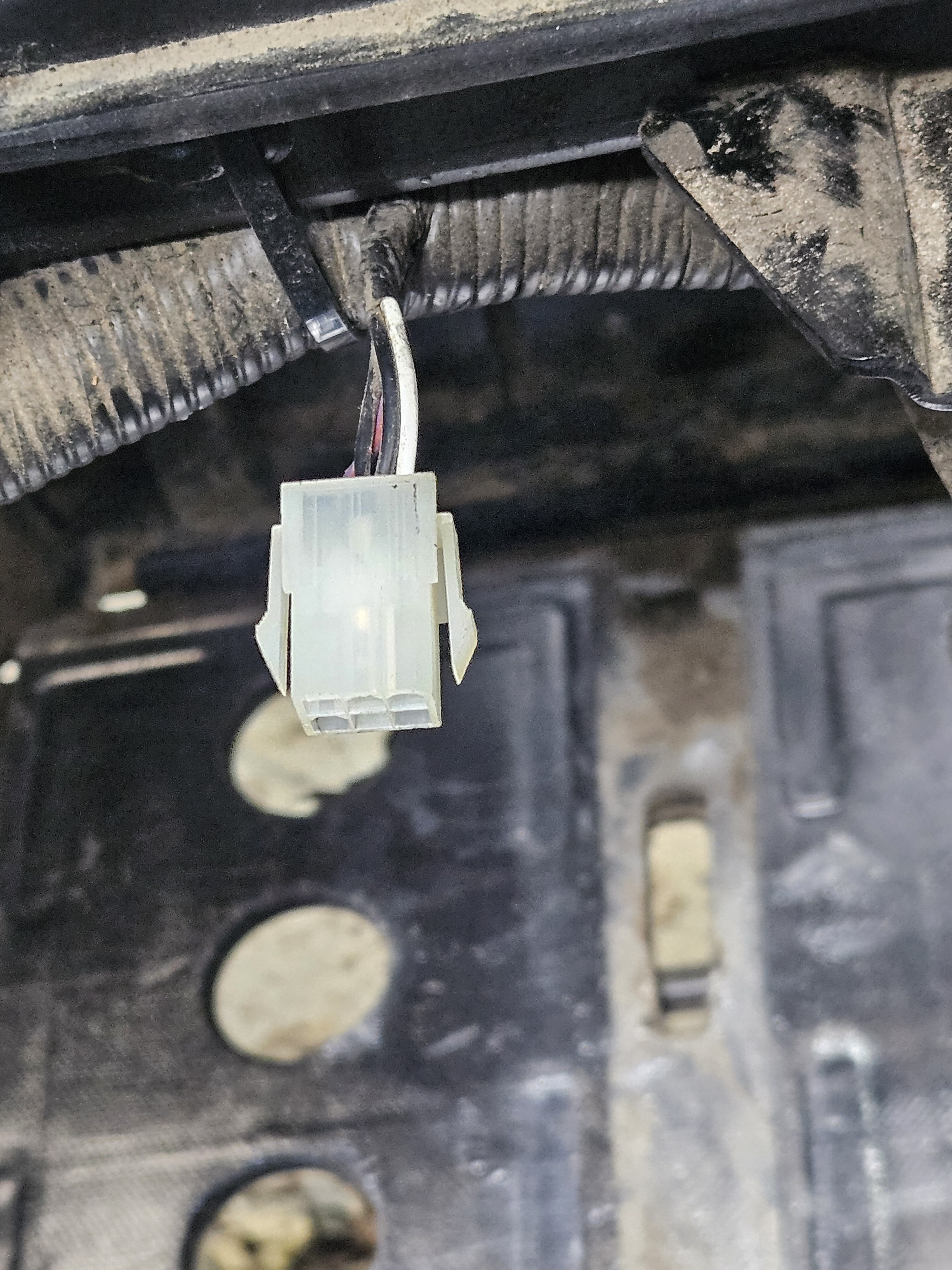

There are 4 loose wires and one loose connector going to the battery compartment (see photos).  The white and black are connected together and go to battery ground.  The red looked like (before it burned and cut) that it went to battery positive.  Am I assuming that these wires make up the DC charging current from the charger?
I have no idea where that 6 pin loose plastic connector goes to (see picture).  Can someone shed some light on that?
I noticed that there are a couple of open male connectors on the Sevcon (see picture).  Both yellow and red wires are connected to their respective terminals below them, but not connected together.  Is it possible that that floating green wire connects to one of those?  The female connector on the green wire is the right size for those terminals.
Obviously I can only tell you what I see on mine, but so far I believe we have the same setup.  As discussed before, the green wire on mine is not connected to anything.  It has a plug connector on the end which seems to have burned up on yours, leaving just that red strain relief that I recognize. In fact, mine has a tag on it that says "Do not connect green wire to ground or battery negative - for interlock use only". The red wire is connected to the positive terminal on the 48V battery at the end of the parallel set, the connector with the black and white wires is connected to the negative terminal on the 48V battery at the other end of the parallel set.  I have the same open terminals below the yellow and red wire connections (although my yellow and red are reverse from yours - maybe it doesn't matter.)  Finally, I have the same loose six pin connector you show. It's just zip tied to the frame with no connection. I'm guessing that it's like the green wire - for use in a configuration different than ours or maybe even unneeded because Hisun used a common wire harness.
