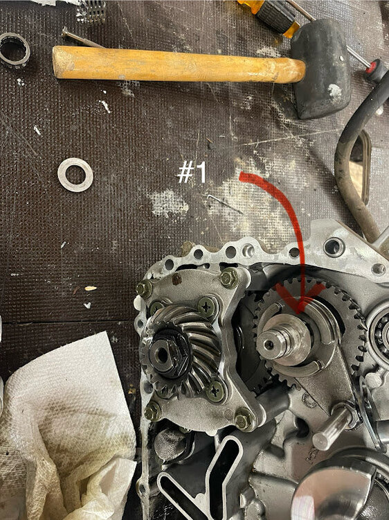

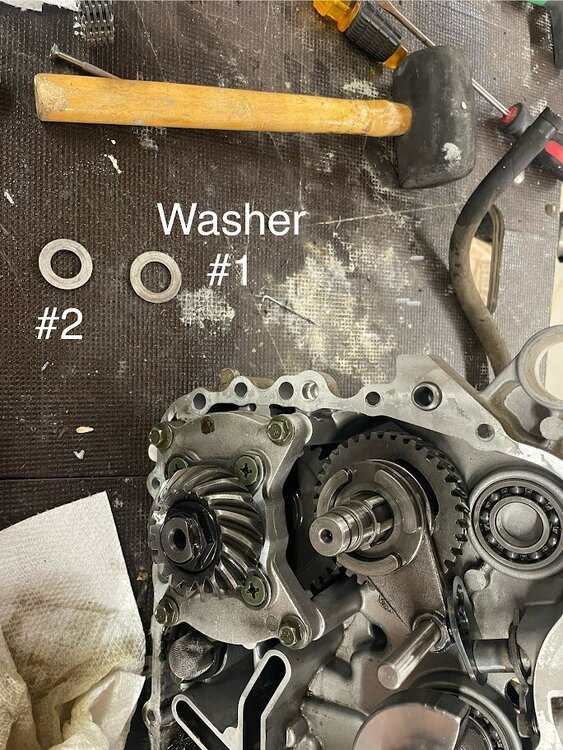

Putting the engine back together after replacing Jose's part so it will shift into F & R correctly.
When I took the two half's apart these two washers had fallen from some where and I want to make sure they go back where they belong.
Washer # 1 I am assuming goes here...
No clue where #2 would go.  Any help would be grateful.  I have the service manual and I do not see washer #2 in any diagram.  I wash thinking that #1 is #26 and #2 would be ?  Also If #1 is #26 there is one not two of them, so I am also wondering if they didn't put all washer in or this service manual is not correct.
  • Solution
I have the answer, received it from Jose, the dude with the part to fix the shifting issue.  Washer #1 is in the correct location, washer 2 will go on the same shaft as #1 but after the gear and bearing, and just push it on over the rubber gasket.
His video is here -  so thanks Jose!
