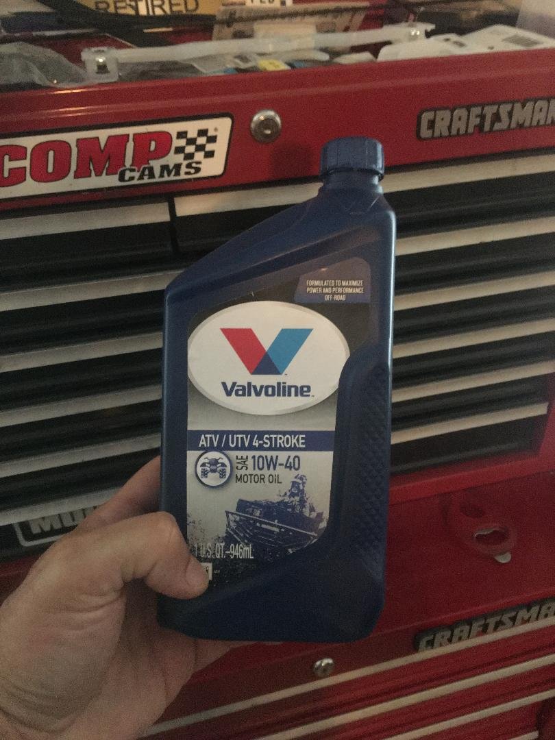

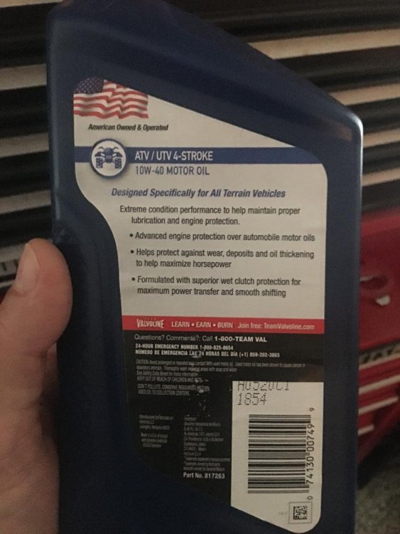

Talked to the Tech at the local service center.  He suggested I change the oil and use a quality 10W40 oil made specific for wet clutches.   He said the units he's worked on have a break in oil with gas in it.  He could not understand why they do that.
He said he's worked on many of these Massimo SxS so that gave me mixed feelings.  1 - he's experienced 2 - why is he working on many of these .....
I hope I get lucky and this solves the issue.  It's 2020, the year of hell on earth, so my expectations are VERY low.
As far as the tech goes, your feelings may be a bit of both. I don't know for sure, but I don't believe there are a lot of certified Massimo service centers around, so he's probably getting more business than if he were working on other makes.
The gas in the oil thing is concerning. Maybe their attempt to spread out their supply of break in oil, or something else that they know about during the break in period that they don't let the buyer in on.

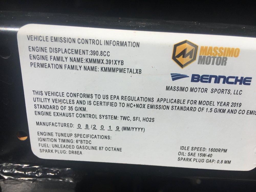

I wonder where you can purchase oil that not only meets the viscosity that the factory calls for, but is also good for wet clutches?
I would put the oil in that's specified in the manual. Nothing special, unless you're going to use something special, and harder to find from now on. I would however, most likely use a synthetic. But if the current break in oil, is diluted in any way, with anything at all. Then that would easily account for your issue.
My thought would be to use the oil that I plan to use. Because its better to know it now, while it still has plenty of warranty time left. Than to finally get fed up with mixed, semi unsatisfactory results, until the warranty is either expired, or at the very end of the service life. Because there's a good likelihood that it won't just be immediately solved. When that time comes, you'll want lots of cushion time. So they can't just immediately fold on the last day.

You can get this oil at Walmart for around $3 a quart.  Meets spec for the Hisun engines in the Massimo/Cazador/Benche 400.  And it won't break the bank.  It's in the motorcycle section.  Don't overthink oil.  The key to oil is buying one that meets spec, changing it frequently, and checking the screen for particles, loose metal, shavings, etc.  These are indicators of wear or something about to fail.  Oil will often tell you if you have an internal problem just like knocks and pings.  If you feel more peace of mind by spending extra $ on full synthetic, rock on.  I do not.  I buy conventional and change it frequently.  The detergents in conventional help these engines.  They are designed to run with conventional.  But you will always find folks that swear by synthetics.  I can rebuild an engine that has synthetic and one that has run conventional its whole life with regular changes...and there is seriously no difference.  The only time there is a difference is when people do not change it when needed.   Like when they skip the break-in oil change interval and put 268 miles on a new machine.  🙂
