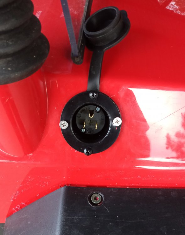

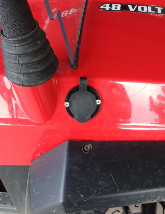

I have never liked the cord in the glove box to charge the E1. It takes up to much room and in the winter the cord is very stiff. So I decided to  install a charge port like the EV's have. I purchased a weatherproof socket to install in the side of the E1. Wired the charge cable to the socket and installed it.  So much easier now to plug the charge cord into the socket, and I have more room in the glove box.

Very neat. I might do this myself. The cable in the glove box is such an afterthought. Mine even has a UK plug on it that came from Tesco - our biggest supermarket chain - rather than anything branded. Interesting what you say about loose nuts. My buggy knocks and clatters like it's falling apart. Time to get the torque wrench out!

I was going to ask, re the original post - what is that socket called - do you have a link? I've looked online but can only come up with 12v lighter sockets or something designed for caravans. I might not be able to source something identical in the UK, but knowing what to look for is half the battle with search engines!
