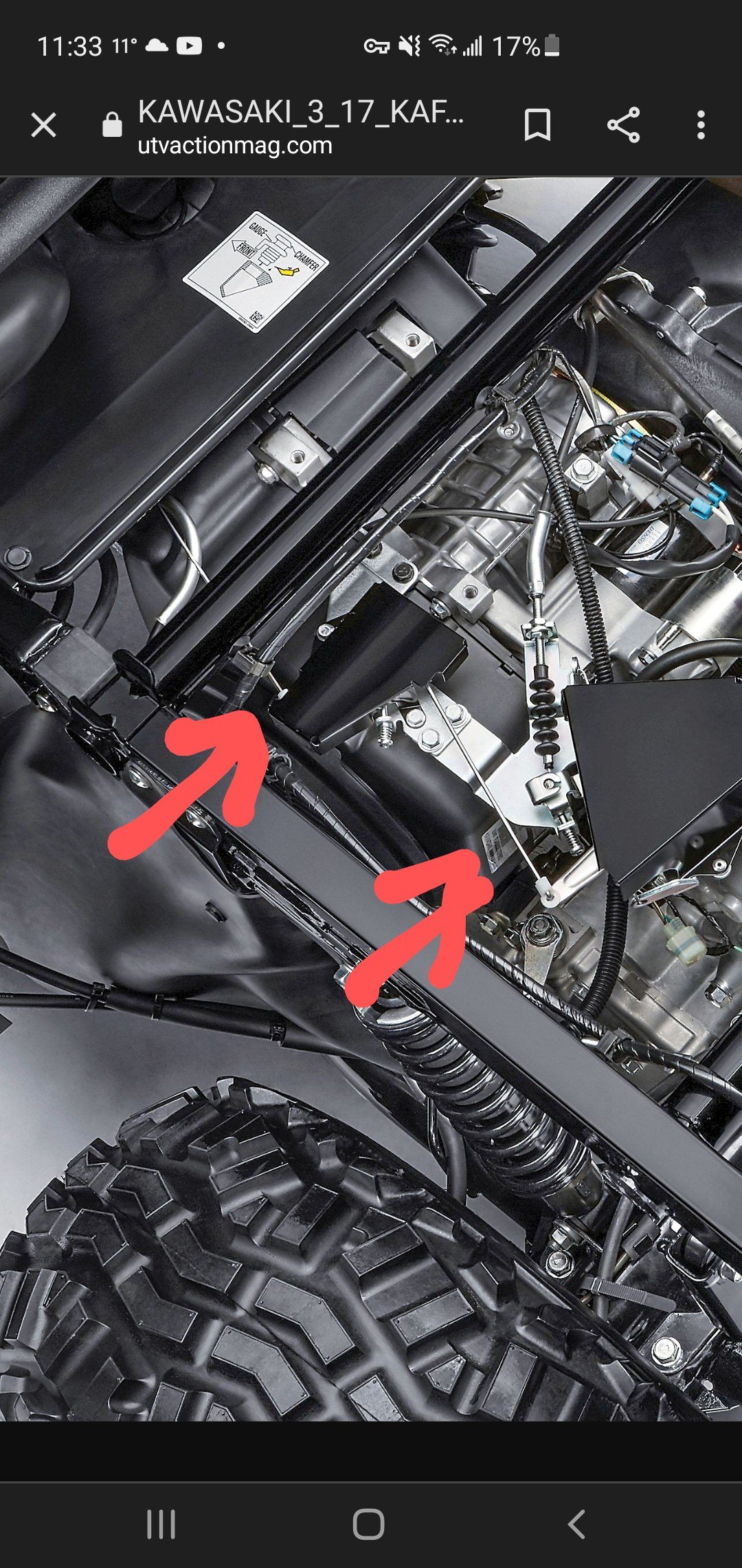

I notice it's not the throttle cable. It's related to these to links.
If I pull either one back slightly it sorts itself out
What is that box?
The throttle cable is the one with rubber boot, is this an advance? Wondering if is a little lubricant spray might help...
I had a few of these do this and Sometimes depending on the hours the throttle plates don’t close properly due to buildup in the throttle body bore and sometimes pulling it off and clean the bores solves the issue . You would think by it not closing the idle would hang  but it doesn’t it due to the sensors giving false info to the  Ecu . There also may be an update kit to help with this I don’t remember. Like the previous reply , if it’s under warranty take it in . They can also run the vin and see if it has other needs.
