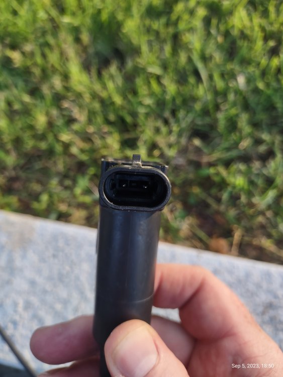

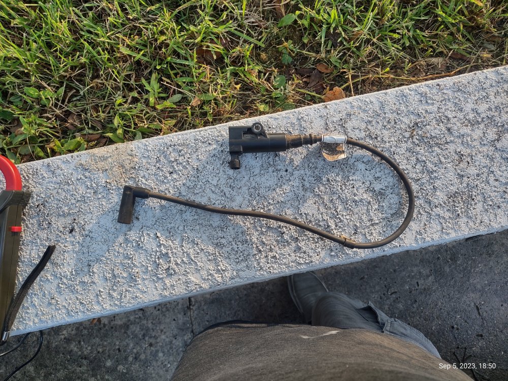

  • If I use spark plug tester or ground to engine, no spark.
  • At the connector to the ignition coil I get consistent 12v on the white wire and nothing at the black. Read in one of the posts that the 12v to the white wire should be intermittent when trying to get a spark at the plug?
  • Tested ignition coil using a multimeter on resistance setting. Between two pins I get 0.46 ohms or thereabouts. Between either pin and spark plug boot I get somewhere around 16k ohms. Not really found a good video on testing these coils but think those are good readings.

Should have posted an update but got it running a few weeks ago.
Replaced the ignition coil and HT lead, cleaned all connections out with electroclean and tightened a few connections and she fired right up.
