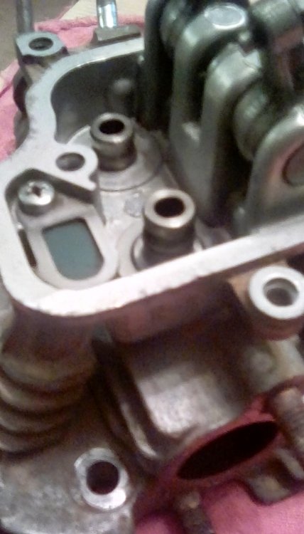

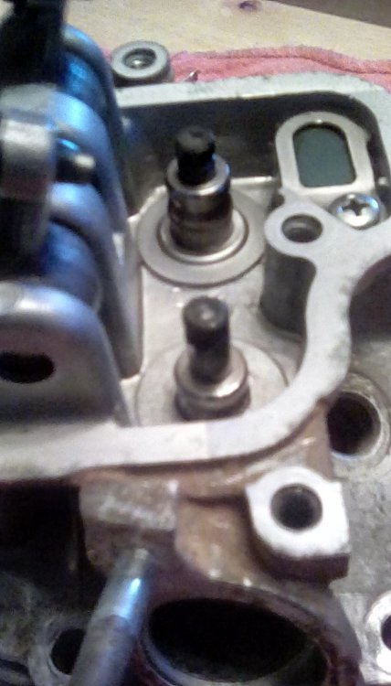

I found a video, where the guides where uneven, and the tallest one wasn't letting the intake go down far enough cause the top of the valve  spring kept hitting the guide...
I think we can call this case closed. Verdict i believe is. The tallest is the guilty party. What do you think gentleman of the jury :)    ?

Just looking at the link. I'd say put the clips on, and drop em in. Well lubed. They're the same part number, so they'll be the same height and everything else. They'll drop all the way down till they bottom out on the clip. If not find out why.
Sometimes just taking something apart does the trick. When you put it back together, it just works. Don't even know why it worked. It just does! But not always, so there's that.
The good news is that this WILL work!
The bad news is that I'm hanging it up for tonight. You keep at it, and when it's right you'll know it. Don't be afraid of pulling it back out. The spring probably sits on top of the clip, to hold it all down.
Link to comment
Share on other sites
It's too early to throw in the towel just yet! The buggered up guide could probably have the rough spots dressed out. Or just replace the guide. If it's still in the head, then you could probably get the tool to remove it. That tool will also help replace the new one.
As long as the head itself didn't get any real damage then nothing has changed, just a setback.

I contacted Our local machines shop, Ted's Engine repair, he said he's not 100% sure if he can do it, since it is a smaller head. I m gonna take it to hm tomorrow and see he can, take em out.
And then what i'll do if he can take em out, i ordered a new guide (s) because they wore past the service limit (measured today), so i'll have new ones he can put in too.
