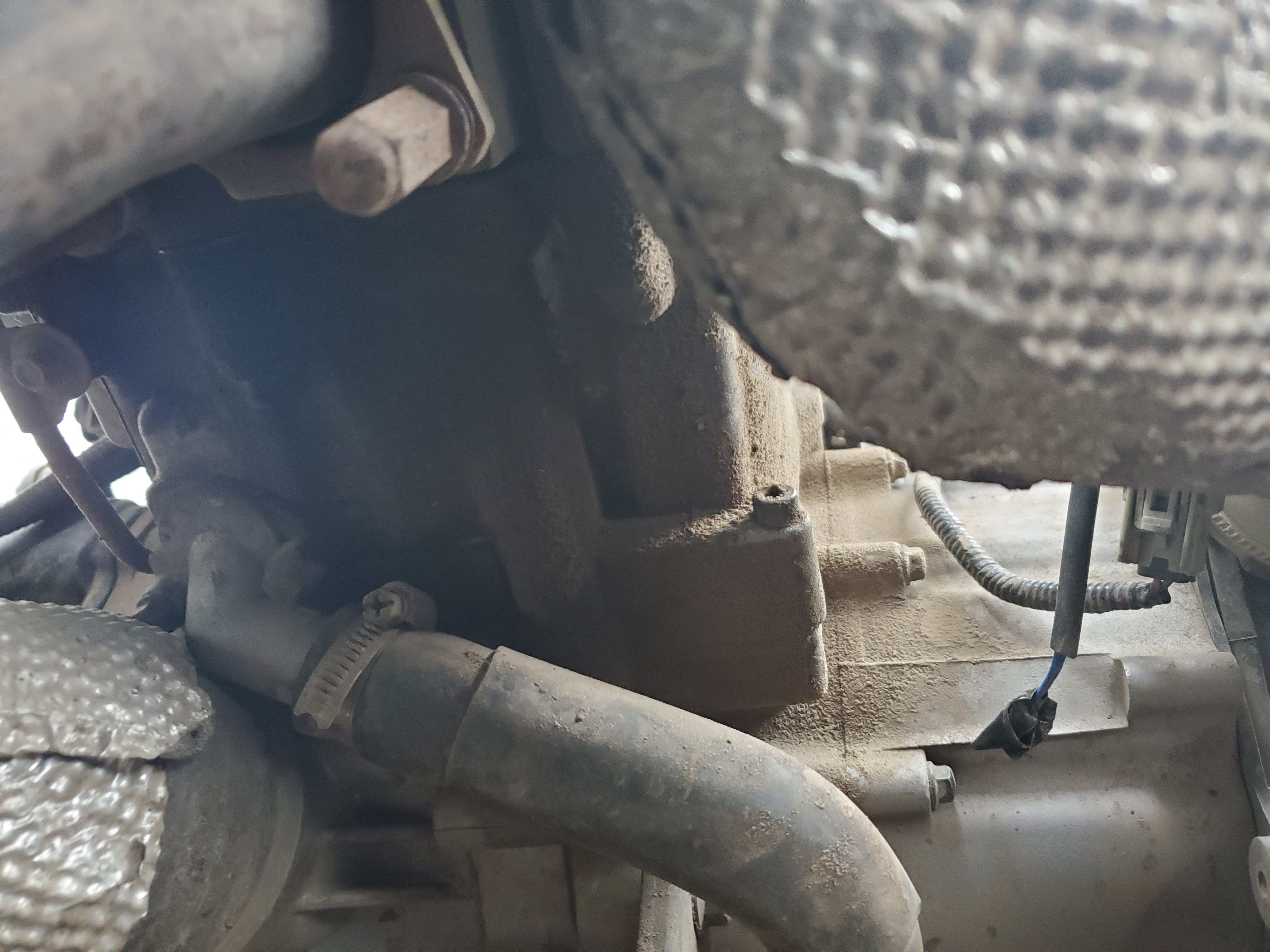

Massimo Tech finally called me back just now .. There IS  a Thermostat. underneath the engine..... I asked about air pocket being the cause , they advised to jack up machine in front , remove caps on Radiator and recovery bottle and run it . watch for burping . I ll try that first ..
20200514_181113.thumb.jpg.305df5917de05fc37b9ba159dccaedf8.jpgHey Joe I had the exact same problem with my 750.  Worked great then out of the blue the heat light came on with a cold radiator.  After alot of research and troubleshooting I found their is a bleeder screw on the housing on the driver side of engine on the hose housing and a second one down at the waterpump at the back of engine.  I bleed the top one and 0 water.  I went to the lower one(which is a nightmare to see and bled it and then went back to the top one and bam it now works great.  As you are doing it you have to keep radiator full.  My reserve was full the whole time but the trapped air didnt allow it to move.  I included a pic I took with my cell as that was the only was to see it.  The bleeder is the bottom right of flange.
thanks   a lot .. I will do that after T-Stat is done..   how does air enter a closed system, I wonder ..  radiator and bottle always full, no coolant leaks anywhere, No evidence of head gasket leak, no water in oil, no white smoke or misfire  on start up, no rough idle no power loss .. The machine runs perfectly all the time.. just no water circulating.   This is the first issue its had in 3 years
I had exactly same question.  I bought mine used and had no issues.  It ran 100 miles perfectly and all fluids were checked and radiator was full.  What I found was it does not take much for it to become air bound.  I once smelled antifreeze so went thru and tightened all clamps and checked for leaks with none found but I did find one clamp that I tightened a few turns so could have been sucking air.  Good luck as I think the thermost is on the bottom and a bear to get to.  You may want to try the bleeder first and see if it helps.
I bought mine new in 2017.. it has always run perfectly.. It goes thru anything in 4 WD Lock... You are right the T-Stat is on the bottom of engine .. a real pita to get at .. Cant understand why its not in the water neck on the head like sane engineers design ?   Thanks for the info.. I ll run it on the trails next weekend.. I hope its cured..
