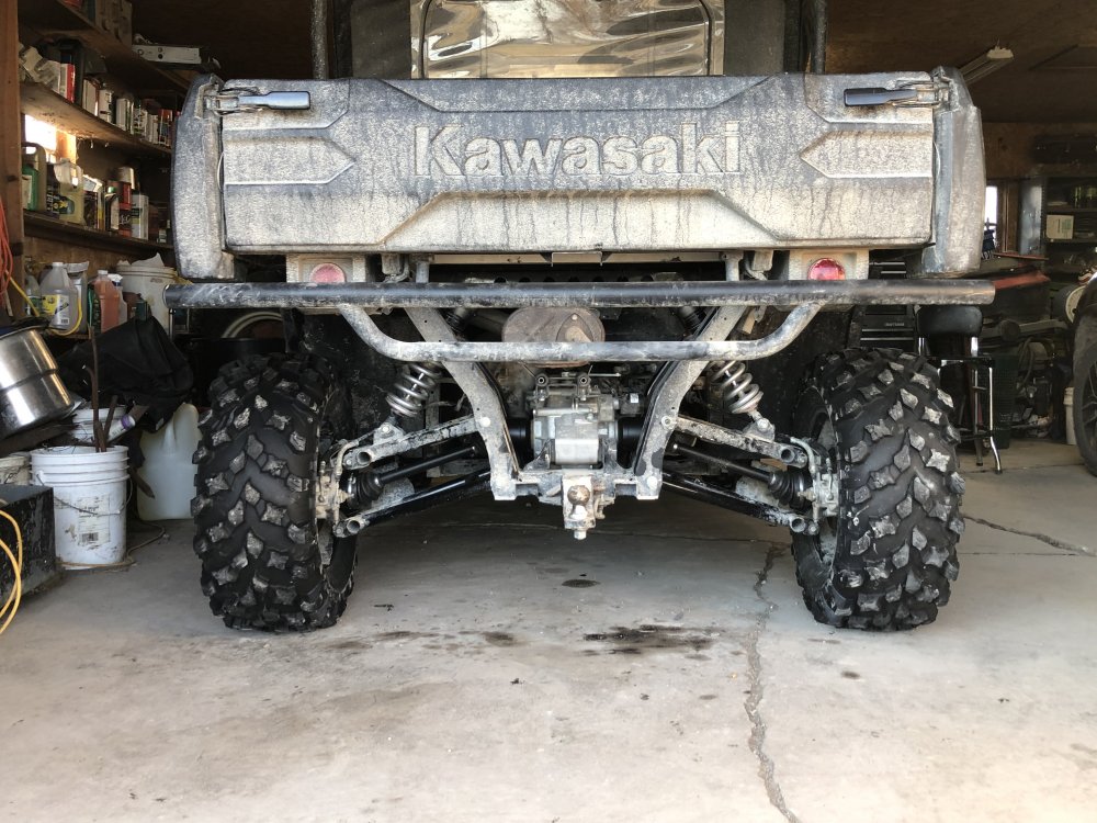

I have a  2016 Kawasaki mule pro FX ,I seem to be replacing cv boots on the inner rear and have tried several different kinds, this unit doesn’t get used hard and has a lift on it

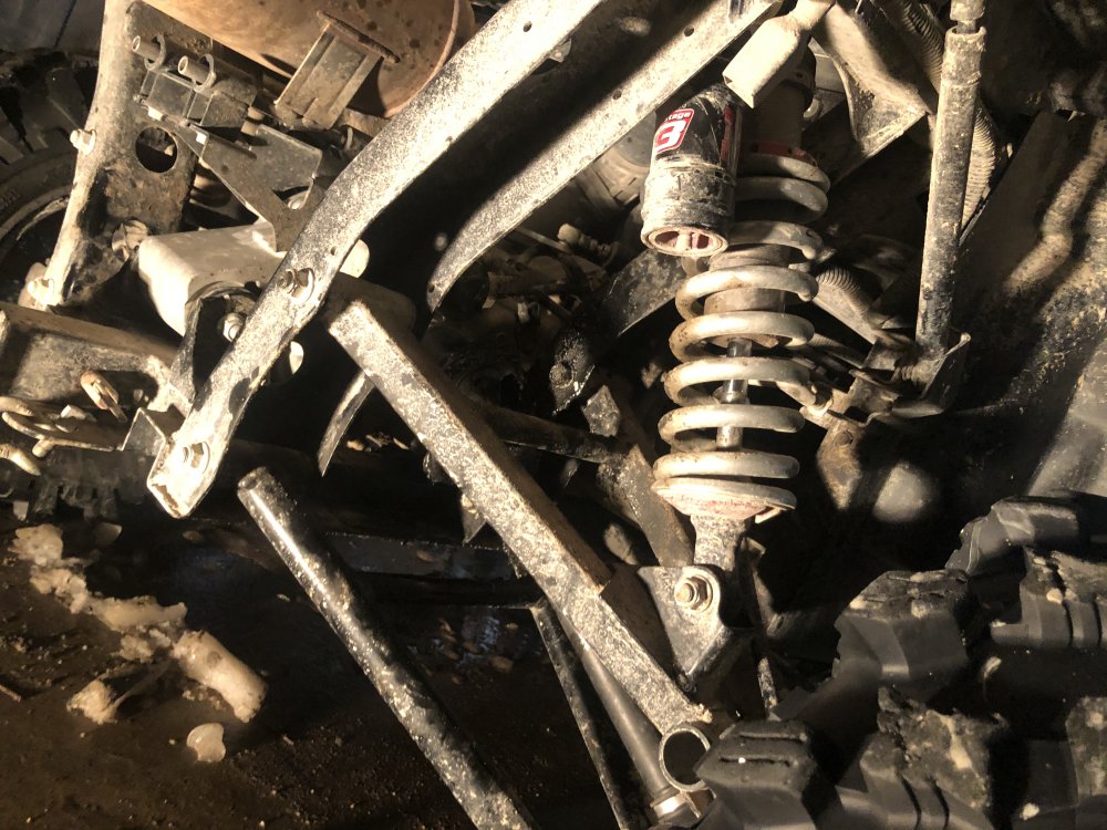

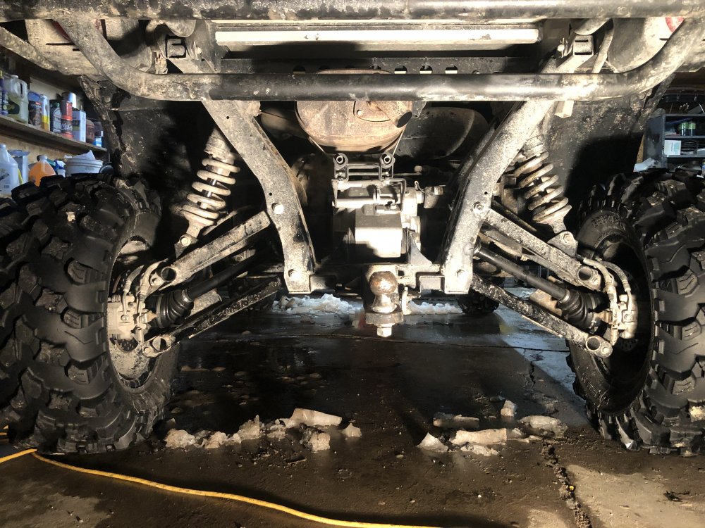

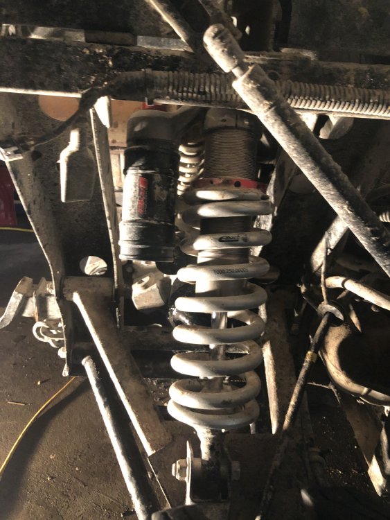

Yes, and it has Elka suspension shocks on it and I’m thinking the CV shafts are at to much angle.
BINGO!--I read this in your first post " has a lift on it " and thought to myself--well there you go...
Contrary to popular web-based "fast &furious" opinion, and every now & then,  the engineers that design this stuff actually do know what they are doing.

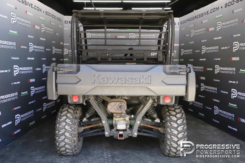

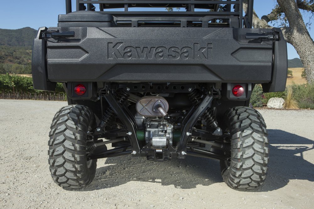

I found a couple "rear-end" photos on the web of what are stated to be stock 2016 Mules:
2016MULEAssEnd-00.thumb.jpeg.cdaf2870fa96bb340851f2834e900636.jpeg2016MULEAssEnd-01.thumb.jpeg.ad2035c263b1eb0027e3cb7de78ea9ad.jpeg
Note the angle of the axles as compared to yours. Adjusting the preload of those poorly conceived aftermarket shocks will not correct that. The issue is the overall "eye-oi-eye" length of the shock--I would replace them with stock, or at least 1"-1-1/2" shorter units. However in comparing your and the OEM photos it seems as though the top mounting point of the aftermarket shocks is further outboard then the stock shocks (which would raise the suspension); it may be possible to move that top mounting point inward to the stock position and lessen the ridiculous angle of those axles.
Also, CV joints stop being constant velocity when operated at such extreme angles, whichj can (and usually does) lead to other problems with differential bearing and gears, an wheel bearings.
My idiot California nitwit step-son completely fouled up his 2017 Tacoma 4x4 by installing some cheap 6" lift-kit that was nothing but longer struts--screwed up the front and rear differentials, axle shafts and transmission due to the jarring dynamic loads created by the CV joints being at such extreme angles. The good kits relocated the differential housings downward to maintain a sensible axle angles.
So it seems that I should get stock shocks back on this and get rid of this high dollar shocks that come with it and it may save me alit of headaches.

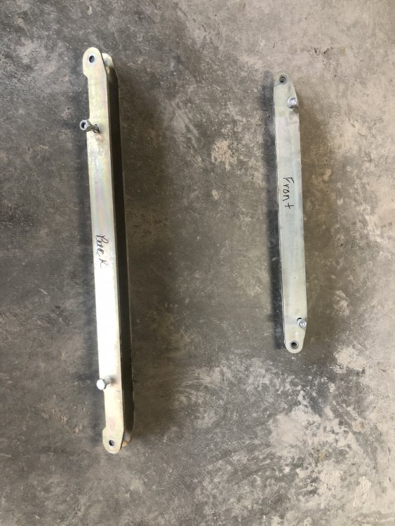

Took out the lift bars and put the shock back in the stock position and the cv shafts are better positioned too, much better than before.
Looks a lot better--the boots should do much better now; they were twisted up tighter than my ex-wife's panties.
I suspected there might be something you could remove or reconfigure--just out of curiosity, do you have a photo of the lift bars?

This rig was fairly new when I got it and the guy that got it new put the lift and shocks on and bigger wheels and tires , it’s nice with a lift for rutted roads and timber but the CV boots get ridiculous replacing , lowering it down was good, it even changed how it rides.
