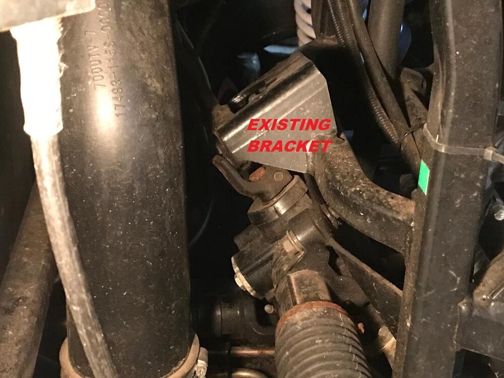

I have a 2016 550, ive tryed the hisun website and seems i cant get parts there. I would like to add power steering, have seen a few "kits" on ebay
for the 750 not sure if its the same parts needed for the 550, there is a factory bracket already welded to the frame above the standard steering rack, is this to be used
to mount the eps motor? There is also a grey plug hanging just above the brake master cylinder, not sure if thats anything that needs to be used in the install.
Handy with wrenches so if i can find the parts installing it shouldnt be a problem, anyone done this upgrade, was it worth it?

I have a 2016 Sector 750 and it also has the welded bracket from the factory.  None of the kits I have found account for this as they all seem to include a metal bracket.  The bare minimum you will need are the Hisun EPS motor, Controller (and power), motor to rack coupler, and shorter steering column rod.  I do not know if all of the 2016 models have the EPS controller connector on the harness and the frame mounting points.  Mine does have them under the hood cowling as shown in some of the YouTube videos I have watched.  The kit below has everything needed but also includes the metal bracket that ours do not require.  I am not endorsing that seller or the product, just using it to illustrate the components needed.

So the eps motor would bolt up to that bracket? Do you have any pics of the install?
