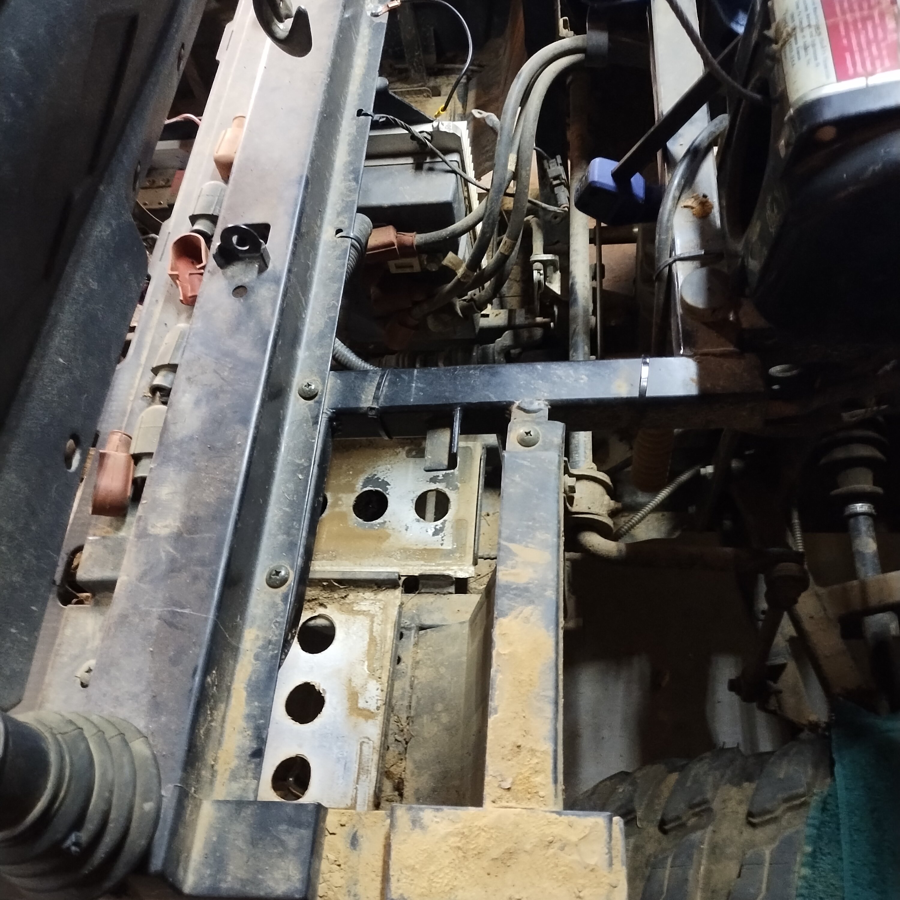

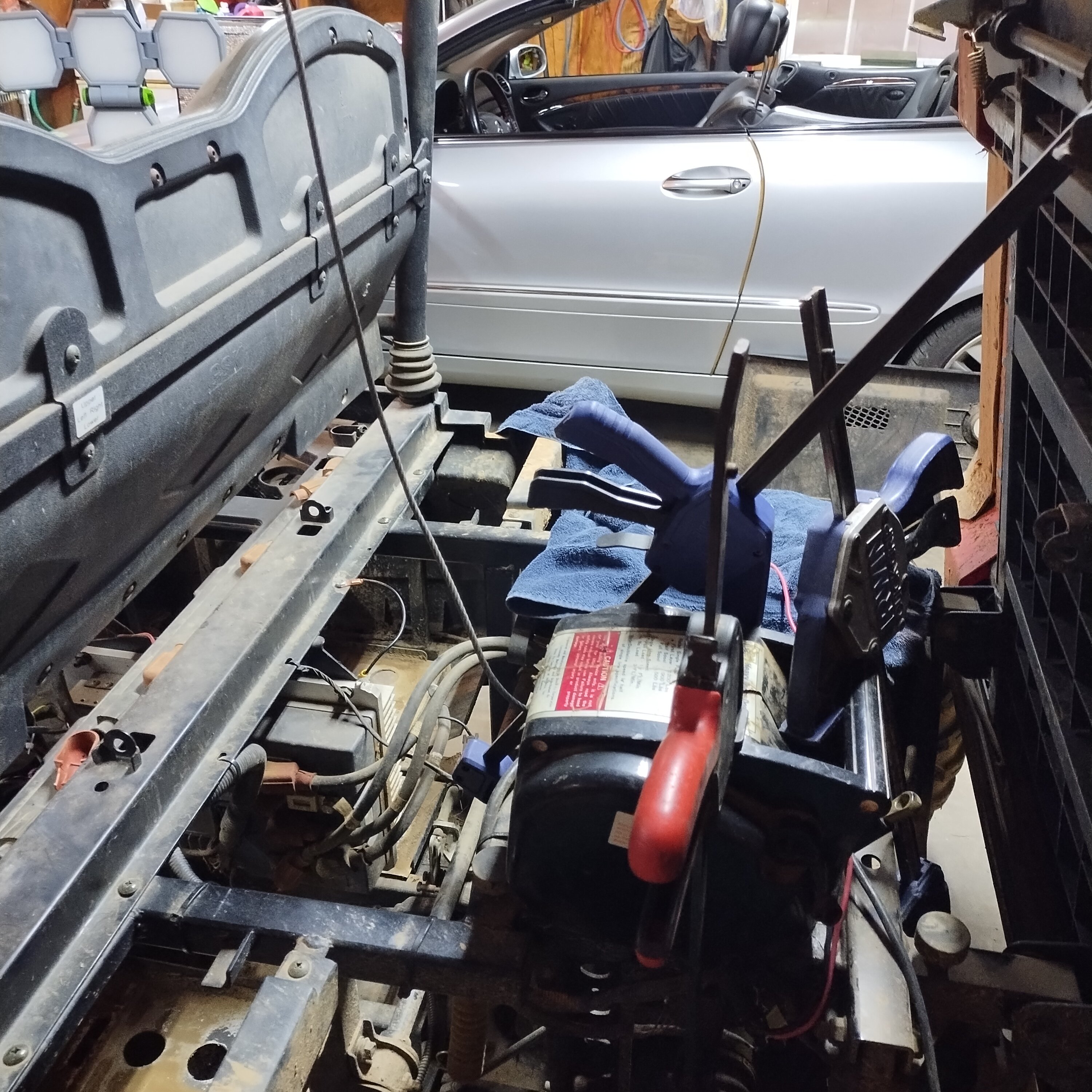

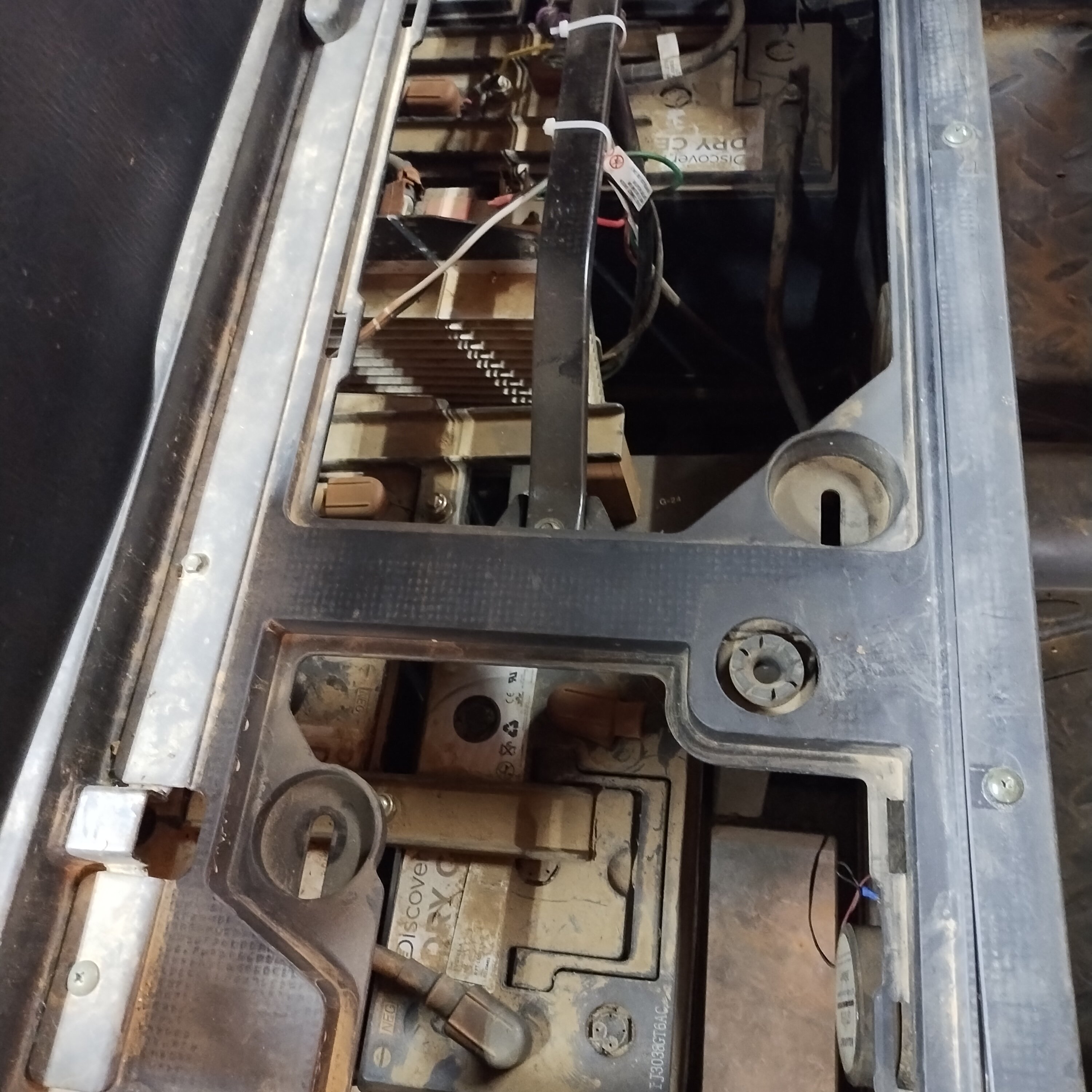

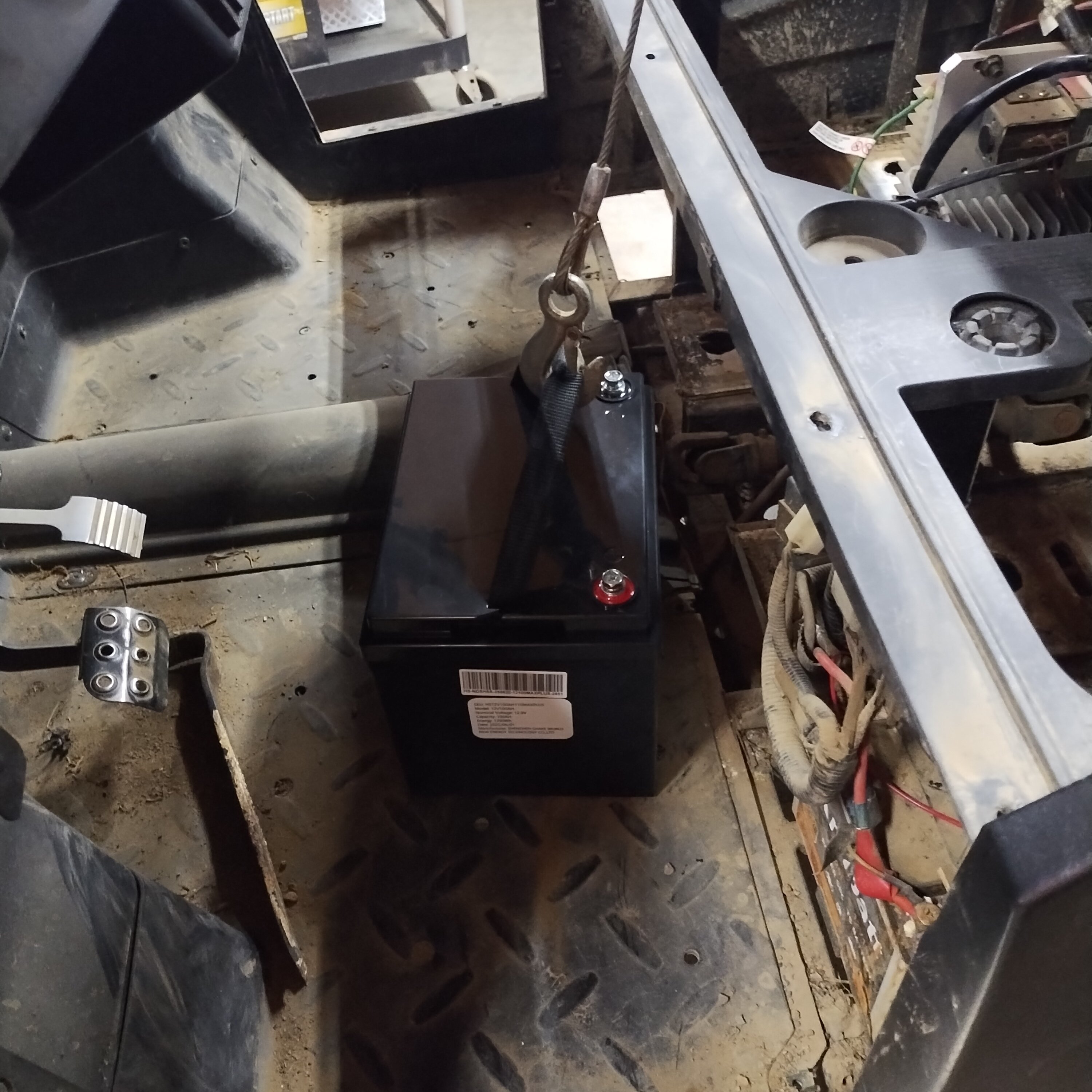

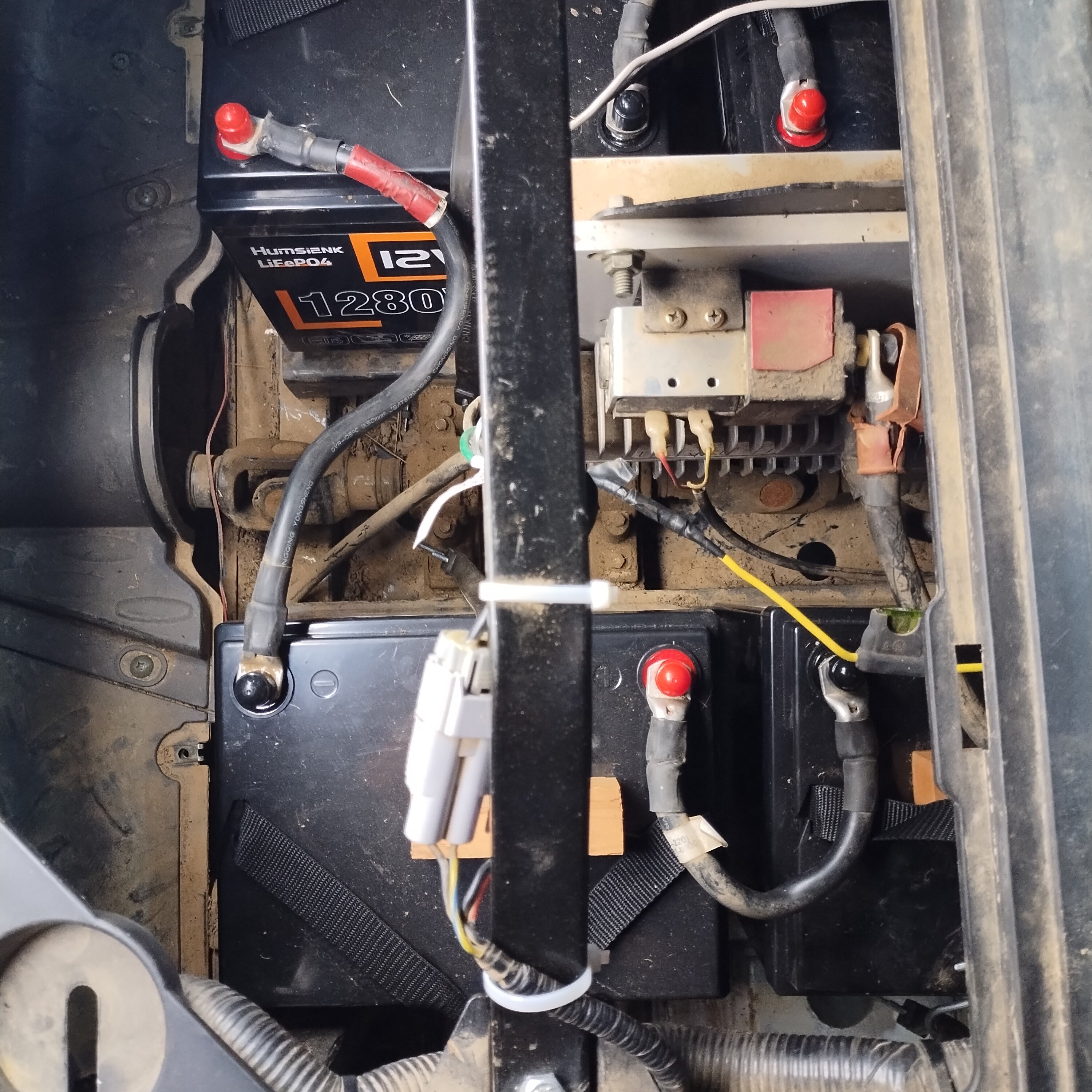

After much thought and reading I have finally removed the very heavy Discover lead acid batteries and replaced them with much lighter Humsienk Lithium batteries. The process took most of the day with a lunch break and a few other breaks. I rigged up a winch in rear and ran the cable over a pulley mounted over the batteries. Made the removal of the 65 pound batteries much easier for this 80 year old! Installed the four lithium batteries inboard to be able to use the existing cables. Used heavy duty rubber bungee as tie downs. Connected all the cables and fired it up and took it out for a test drive. Wow, what a difference. More power than when new. Climbed the hills on my place with ease. Should have done this sooner. The dash voltage gauge I installed shows 56.1 volts after riding it all over my 20 acres and up hills. You may ask why the four 12 volt and not just one 48 volt battery. For two reasons the 48 volt battery is really heavy and difficult for me to maneuver into place, and secondly, if one of the 12 volt batteries goes out, I only have one battery to replace. But if the 48 volt battery goes bad I will have a much larger expense to replace it.  One thing I noticed, the E1 is about 1.5" to 2" taller! Humsienk has a five year warranty and the batteries generally last ten years.  I will post an update down the road.

Glad you're happy with them.  There is definitely a huge difference in weight.  Out of curiosity, with them wired in series you're max continuous output would only be 100A, although from what I could see online they can put out up to 300A for a much shorter time (usually measured in seconds, but I couldn't find the detailed specs from them). What are you seeing in practice? Plus I'm guessing 100aH is enough capacity for the way you use your UTV?
I believe those have a bluetooth connection, although they may not coordinate between each other for load balancing. I don't know if that could be an issue long term, but it would probably be a good idea to monitor the individual battery charges separately in the app until you have a good idea.
According to the printed specs it has 110 amp continuous output. And 2560 Wh. combined. I bought these as a set so BMS in each battery talks to each other. In the manual it warns against using other brands of batteries with these. I am using a smart 48 volt charger. As with anything, time will tell if this was a good move.
Since the four batteries are wired in series, your capacity and output are the same as one battery because they're being used to get the voltage up to 48V. So continuous output will be 110A (with some amount of surge above that for a brief period), and since the Wh of a single battery is 1280Wh (printed on the side of the battery), that means your total capacity is also 1280Wh, or about 107Ah.
It's that nuance about series vs parallel batteries where the Hisun numbers in their advertising with the Discover cells is just plain wrong.  They list the sum of all 8 batteries as if that's the total capacity, but because they're in series to get the voltage up to 48V, you can't add them up. I was asking about what you noticed on the power because the motor can take up to 400A for max torque, but on paper your batteries have a max continuous of 110A. It's the same deal as the Discover batteries. On paper they can only put out 100A, but can surge higher than that for a limited amount of time.
If you're happy with the performance and range, none of this matters.  I just wanted to make sure you were aware how the numbers add up.
