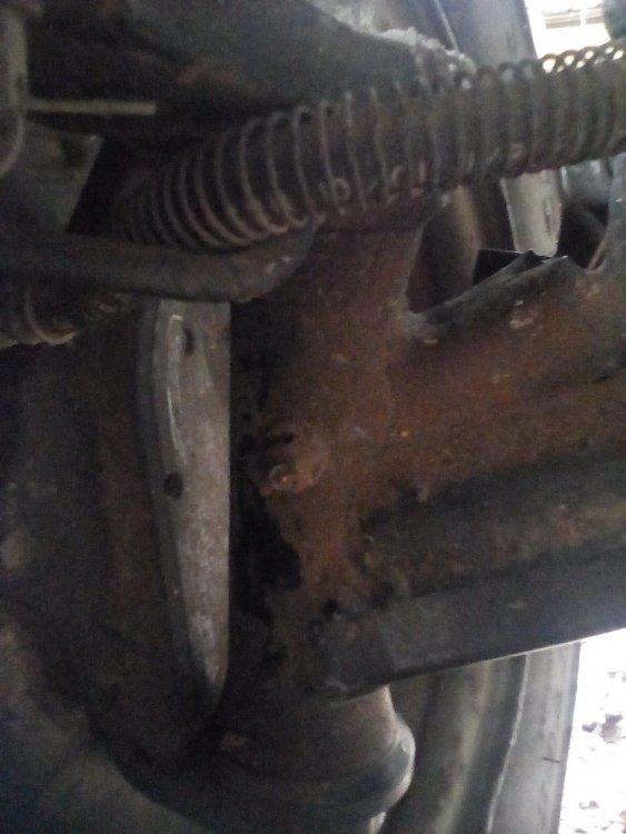

I found 2 grease zerks I never knew it had,... They are On the front end, back side of where the tie rod comes from the steering, and it lubes  the shaft that pivots the spindle and wheel to turn it.... And they are in the hardest place to see.,  Never mentioned in the owners or Service manual.

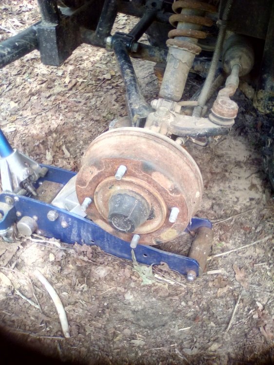

 Remove the wheel.... 4 lug nuts. then jack the front end up and support it with jackstands and chock the rear wheels.

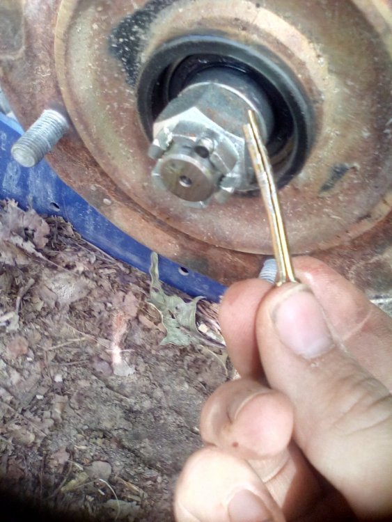

remove the axle nut mud cover.
get a 1 1/6" socket to remove the axle nut... Don't forget to remove the cotter pin! you can use a breaker bar or impact to remove it.
there is a spacer behind the axle nut, remove it also.
now pull the drum off. sometimes it can be stuck on so spray some penetrating fluid between it and the backing plate, and tap it with a hammer while spinning it . you may have to use a 3 leg puller.

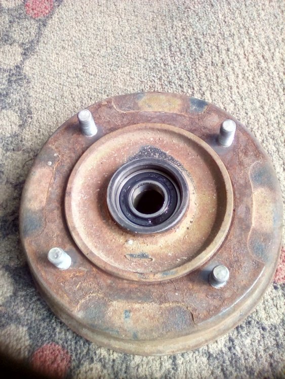

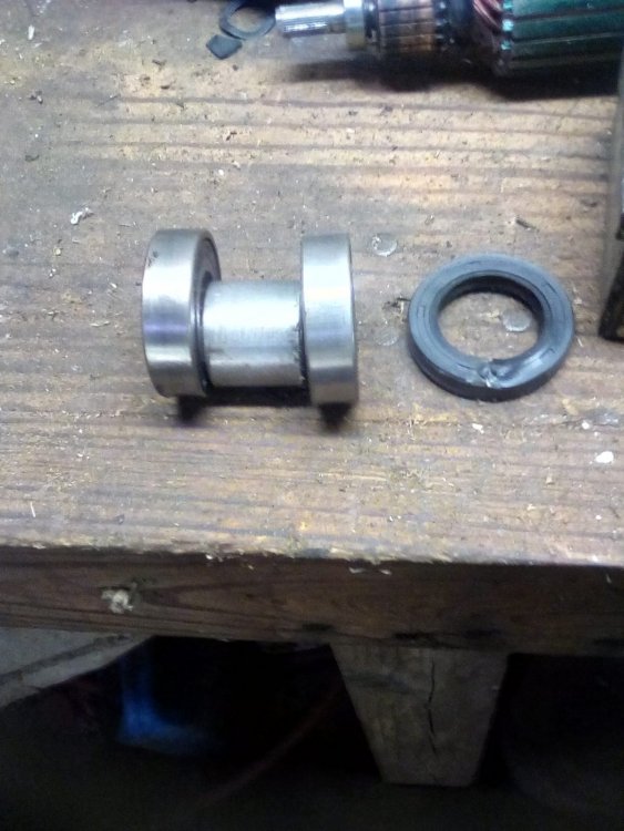

Now that the drum/hub assembly is off, this is what you should see.   the drum houses the bearings. there are 2 bearings, 1 spacer and 1 seal. the seal goes on the back of the drum, facing the brakes. the spacer goes in between the 2 bearings.

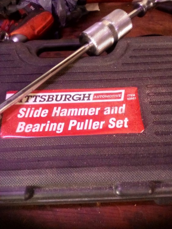

Now, my manual and also my common sense told me to PRESS  the bearings out. You CAN NOT press them OUT. there are 2 ridges that control the depth at which they are installed and you CAN NOT press them out.. you must use a slide hammer puller.
and you have to do it 1 bearing at at a time. Don't worry, the spacer is supposed to move freely in the drum.
I used the 3rd biggest puller attachment in the set.1766953717_IMG_20200506_1116451.thumb.jpg.d1fae08b06bc944c197573e8d9723f16.jpg

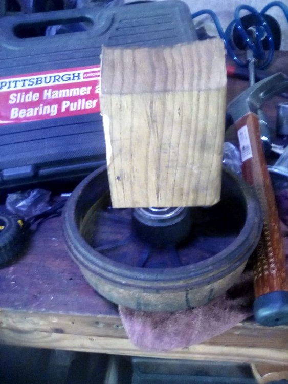

i used a flat piece of wood to drive them in straight and then a 13/16" socket to drive them into the ridge, they are about 3/8" below the surface.
remember to do one bearing, install the spacer, then the other bearing, then the seal. the oil seal goes on the back side of the drum that goes against the backing plate on the mule. I recommend lubricating the seal lips and outer edge when installing into the drum assembly.468929302_IMG_20200506_1258321.thumb.jpg.53c8010d29f6dfb82c66d49e253783a6.jpg

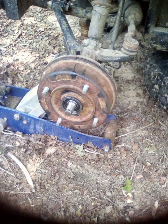

now that the bearings are in time to Reinstall the drum!
just slide it back over the spindle shaft until fully seated... install the axle nut spacer, axle nut and cotter pin. before you install the cotter pin, torque the axle nut to 110 ft lbs.  reinstall the dust cap, tire, and lug nuts. lug nuts are torqued to 25 ft lbs, remove jackstands, let jack down, un chock the rear wheel. YOU ARE READY TO GO!
