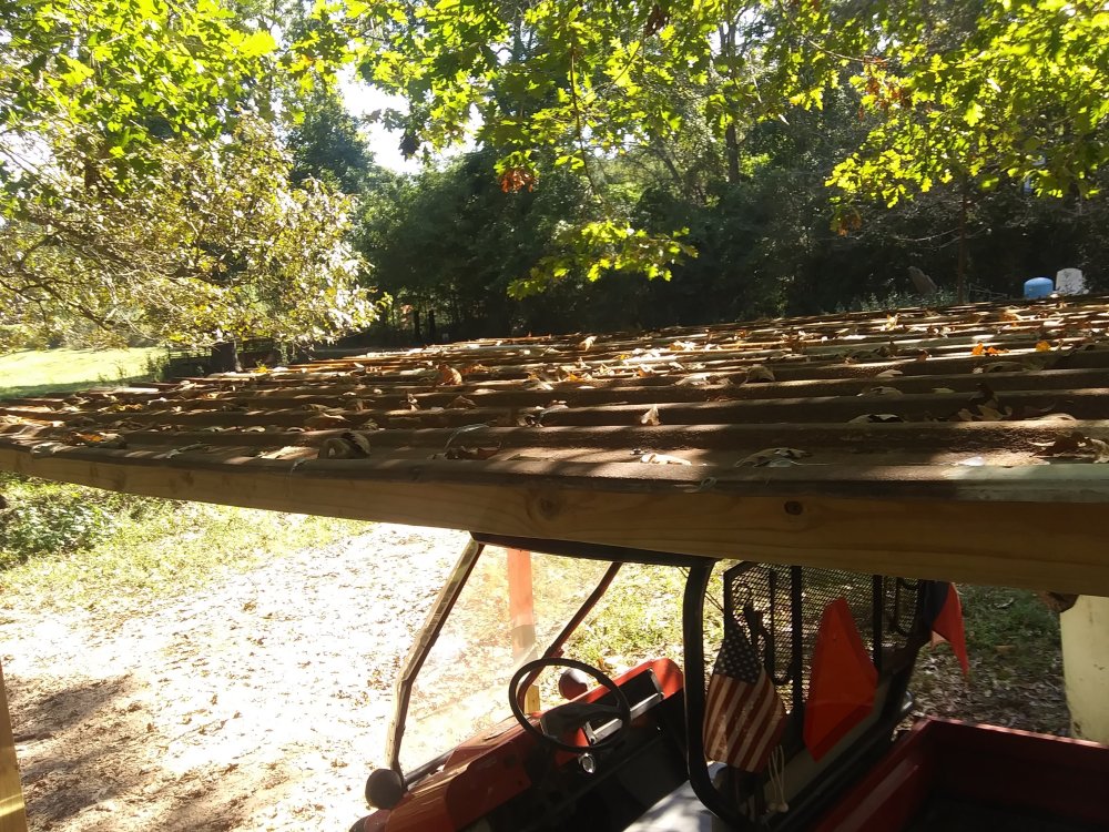

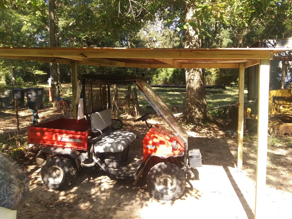

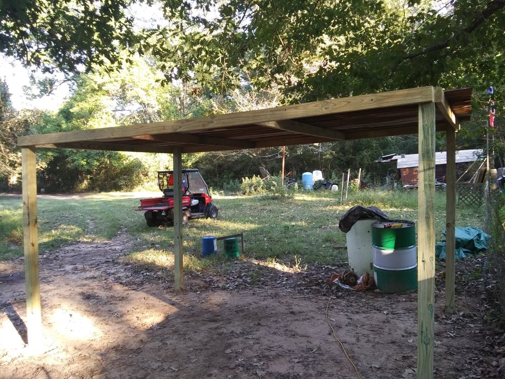

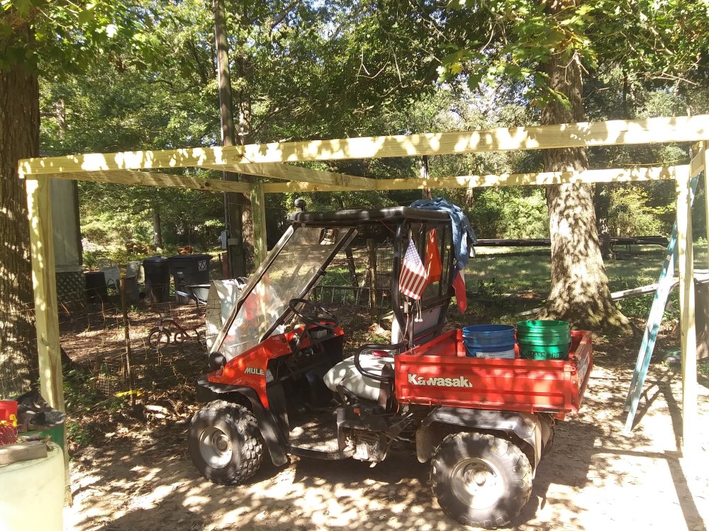

No more tarping her everytime it rains.......
4 4X4X8's, i wanted to use 10 footers, but Lowe's was fresh out so i tamped in 8 footers..., 2 12 foot 2x4's, and 4 2x4's.... i plan on adding some corner braces to help with any sagging that might occur.988549230_20211005_1057301.thumb.jpg.ddd8ada818859f5660f93dce131366fc.jpg597127868_20211005_1734311.thumb.jpg.1ea0810023a25cffe416fbdbb86723fe.jpg
Storms, and high winds are expected tonight. Looks like your project will see its first test. I hope you tamped those posts in good and solid. We'd hate to hear the wind got some catastrophic lift underneath it.
I probably would've used post anchors, set in concrete. But that would've been more about keeping the headroom, that's sacrificed by setting the posts in the ground.
What im thinking about doing is waiting until Lowe's gets some 10, footers back in stock (they told me they didn't know how long it would be) and get 4 of em, I can use the front end loader on the tractor to support a corner at a time, take the 8 footer out, dig down two more feet and get it the same height as the previous 4x4, just deeper in the ground= sturdier.
You should look into pricing the 4×4 concrete anchors. Four of those, and a few bags of concrete might be cheaper, considering lumber prices these days. It serves the added purpose of keeping the posts up out of the dirt.
