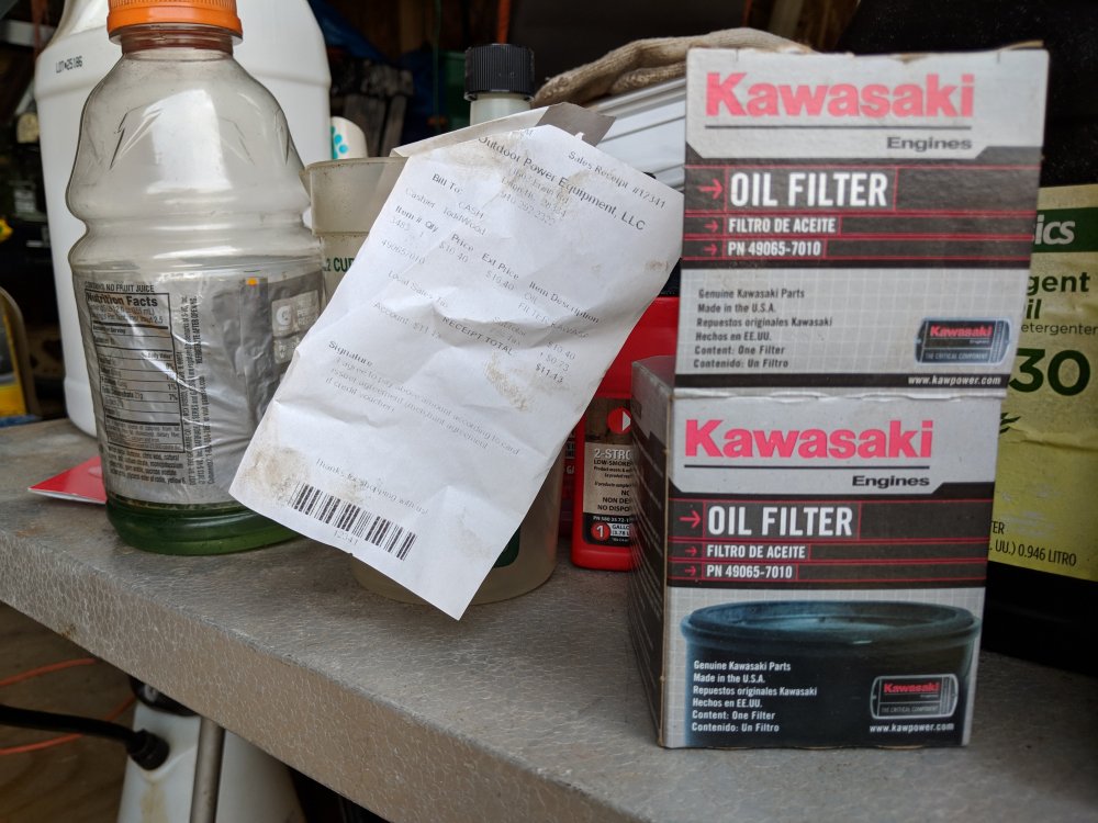

Just a follow-up note. I looked through the cross-reference oil filter list provided by Vaughn and the other provided by Travis and noticed that they both list the Kawasaki 49065-7010.
I park my UTV in my garage and I park my Zero turn mower in the shed.
I have not tried the filter on the UTV yet but the Kawasaki engine on my lawn mower uses the Kawasaki 49065-7010 and I have a new spare for the mower in the shed.
If I had noticed this in the beginning (if I had these cross-reference listings), I more than likely would not have run into my problem. I will try the Kawasaki filter the next time I change the filter on the UTV and it will be my "go to" filter for both machines.

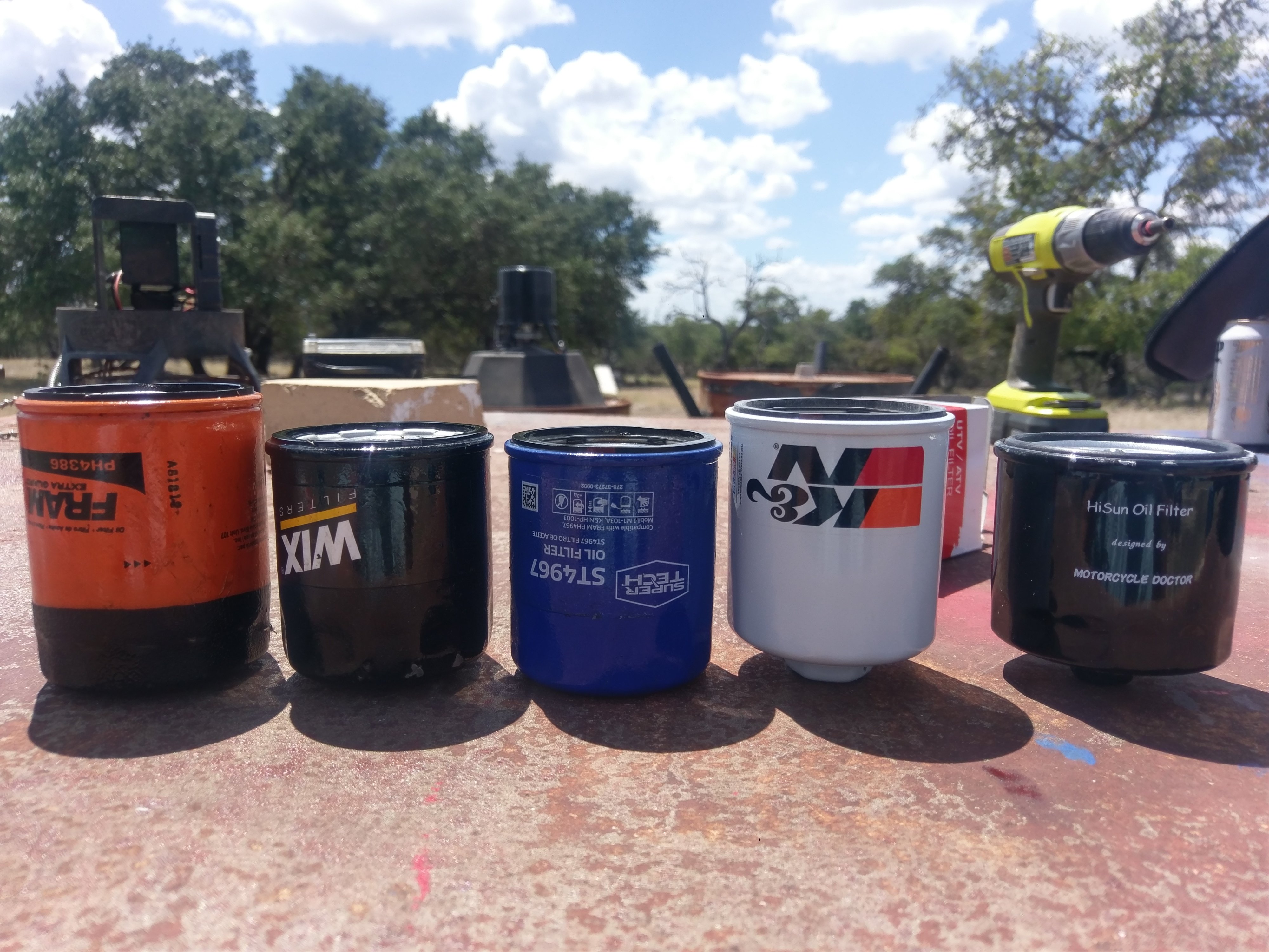

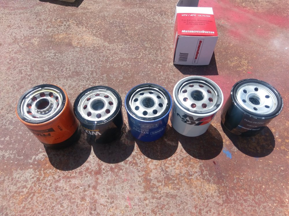

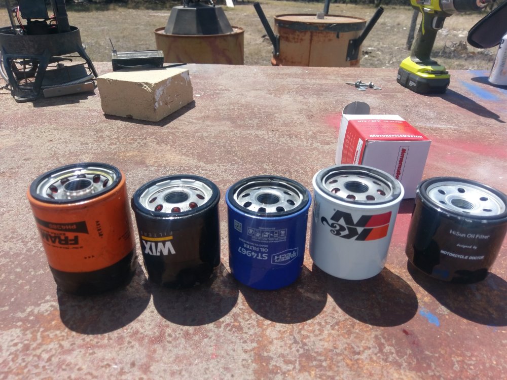

Please post a picture of the gasket side of the filter you are getting. I noticed a significant difference between my original and the one that failed. The one that worked was very much like the original.
Others have posted that they used the brand/type that I had fail so I may have had o defective one. I could not see what made it (the FRAM) leak severely, but it did.
Link to comment
Share on other sites
So the Hisun Oil filter was the only one that worked. It had a much rounder gasket than any of the others.
The supertech leaked the least but still leaked under pressure.
The Hisun pictured above was $8.00 plus $7.75 shipping off of Amazon
Hope this is helpful to someone. The UTV is a 2015 Massimo 400.
Link to comment
I do believe the "CFMOTO" CF188-011300 I used successfuly looks identical to the "HiSun" in your pictures Kannon09. It was only $7.99 and shipping was free if you want to give that one a try.
