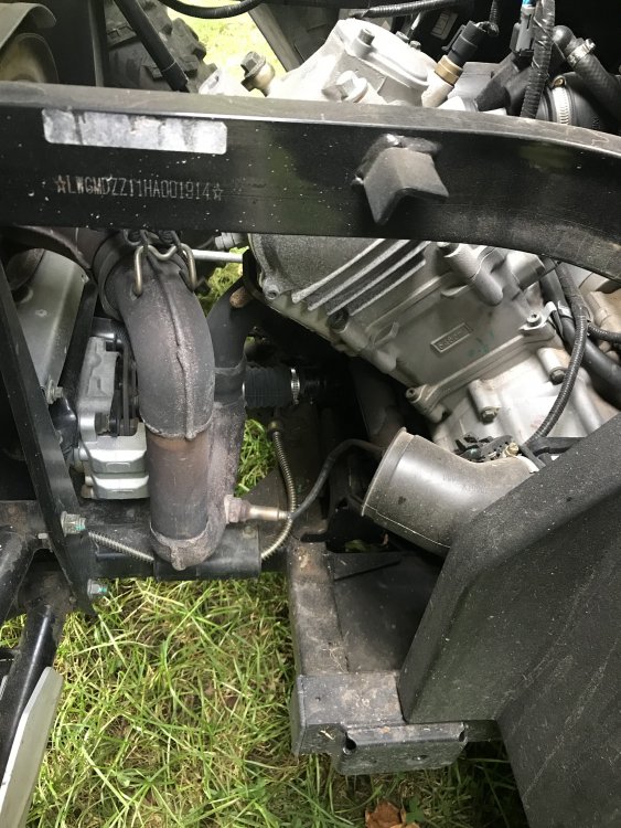

Here is a pic of rubber elbow not attached to exhaust.  I don’t see anywhere that it’s supposed to attach, warm air but not exhaust smell is expelled when running.  Don’t see obvious leak in exhaust or manifold but does have overwhelming exhaust smell.   Thanks Travis for responding.   Jon7A1FD21C-32BD-4D14-8490-635E0E990D7C.thumb.jpeg.f15a539303661913ef90cc6890141ac0.jpeg
Obviously you'll want to make certain that it's not anything leaking. It's possible that the add ons are bottling up the fumes. Keeping it contained.

Thanks. My research found that Noico was the best deal for the $ but I have not ordered it yet. I have another question; On the back wall of the cab, under the bed, is a rubber/plastic hose maybe 2-3" that is not capped. Is this some type of exhaust?
Yea mine has the same open rubber elbow.  I had posted a picture in one of my first posts asking if that my be my source of fumes.  No one seemed worried about it and asked if warm air is coming out which it is.   So I assume it’s normal.   Jon
