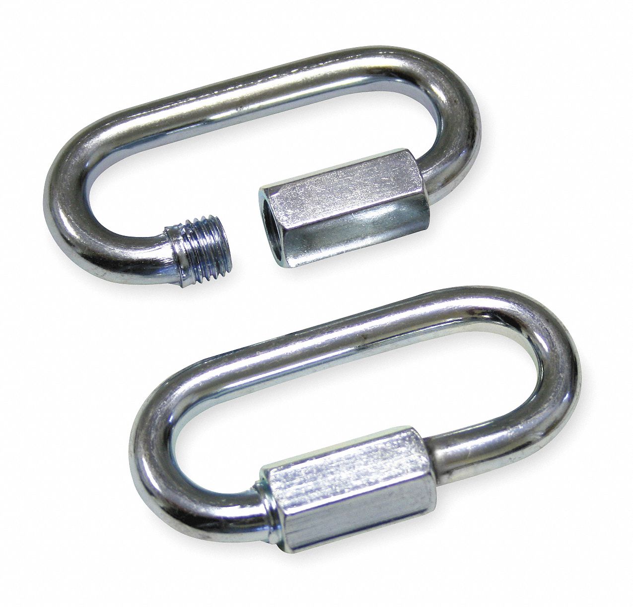

I have 2 sets I can use off a dirt tracker like new but I just don't have the quick disconnects on the attachment points and hate to make them solid mounted...Cant seem to find the quick ones.
Yeah I guess those would work pretty good...Never gave them a thought DAH! I was thinking the quick snap ones like rock climbing and thought no not strong enough.....Thanks I sometimes have my head up my butt LOL..
