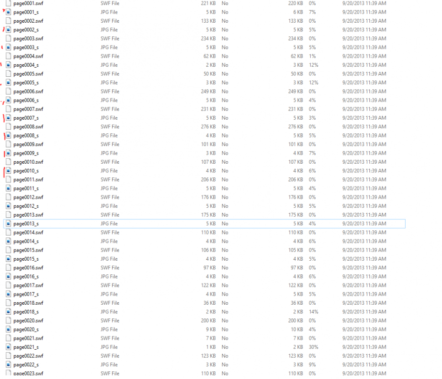

Usually when i wanted to use it, i would put in the CD,  and click on CD drive folder, then click on start, i did find the files, or "pages"  are JPG files. .. i have no idea what those SWF files are, i can't open them.
image.png.f831134ea7cee2549cfe2e4e0e903797.pngimage.thumb.png.4d59432f1112ecd2477e79f1f868f56c.png
The .swf files are "Shock Wave Flash", Adobe's original name for what became just "Flash". They likely just serve up the .jpg files in an indexed manner--I might be able to convert it to something else if you'd like top send me a copy of the CD...

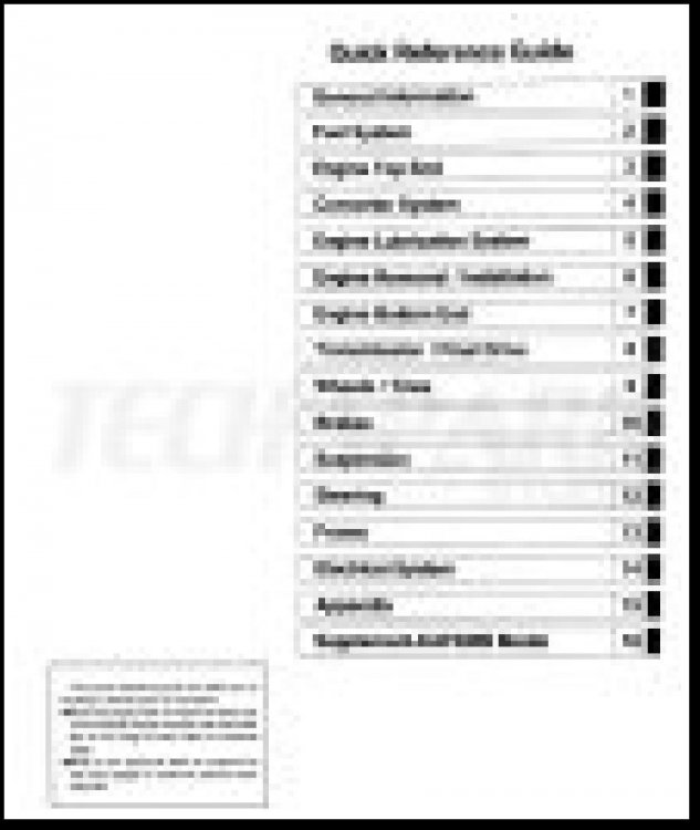

The .jpg files are "thumbnails" of the actual  page images in the .swf files. I'll have to do some research into how to batch convert the .swf images into something useful...

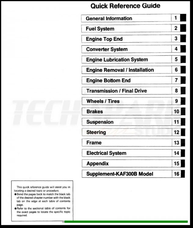

This is the page0002_s.jpg file (viewed with just a plain ol' Linux image viewer(:
Here's the page0002.swf  file (viewed with Celluloid, a Linux movie viewer):
