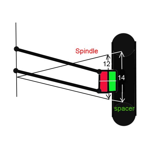

I'm not sure I agree with you Lenny. I think you were right the first time. Although this is a crude drawing; this is the way i understand it. That due to a longer radius; the travel of the A arm also increases.
If you only had one A-frame rather then two and the axel went straight off the end then, the farther you went out with the wheel the more swing you would get. The wheel would also tip from in at the top when up and out when down. But the axel is parellel to the ground and stays that way through the arc. Now extend the axel out another 10" say or 10' for that matter and it still stays parellel to the ground and goes through the same swing. It's because you have 2 A-frames to hold the axel parellel to the ground that everything stays the same.The only way to increase the travel or leverage on teh spring is to lengthen the A-frames.
Lenny
Ohhhhhhh! Now I see what you mean. Yes; the spindle and the spacer are parellel to the ground. Thanks guys! Physics isn't my strong suit. :D
However; there would probably be a bit softer ride due to the force point being farther out from the pivot point I think. (Same as gripping a wrench up close to the nut rather than at the end where you can get more torque; or the use of a breaker bar)
