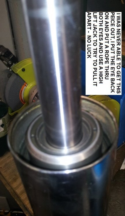

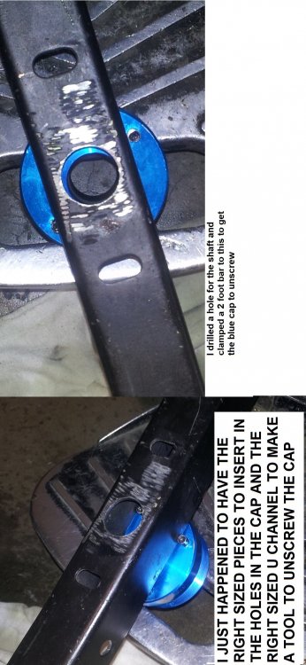

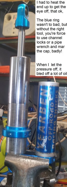

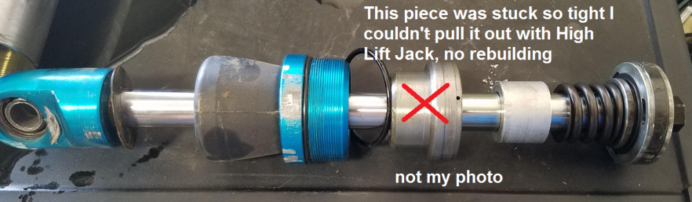

Because UPS seems to be waiting a day to process my orders from F-O-A, meaning what should be here today or tomorrow won't be here until Monday, so I had time to figure out how Yearben shocks come apart, I could labor on and tell you, but I'll let you figure out your self if you buy them, my opinion, I'm not too proud of them, they don't lend themselves to being rebuilt because I doubt the main shaft seal probably won't be available, the rest are just O-rings, once you figure out how to get at them, they use what appears to be a special compound to seal the seal and the threads, the nut that holds valve pack in place is welded, so you can't tune them.
I think they are a one use and replace shock and mine didn't last long enough to suit me and I don't how the ride compares to the stock shock because I replaced the rear stock ones on my 08 Trooper in 09 and the fronts in 12 and when I bought the blue 2015 Trooper, I ordered it with the Yearbens, they gave me a good ride for almost 4000 miles, at which point, they were out of oil, just springs, not shocks.
I can't endorse them, but I can't condemn them either, I don't know how much the were, so it's your choice.
